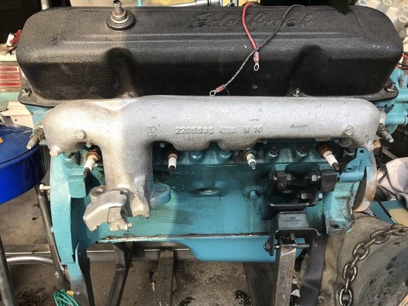

I have a set of log style exhaust manifolds. Would probably work. But you should go with a mini starter and keep the headers.. You wont have to re do your exhaust. If you put any kind of stock style exhaust manifolds on you will have to re do your manifold to exhaust pipes. I was asking 200.00 for these logs.. But Id take 100.00 plus shipping.
Here is the ad for my exhaust manifolds.
https://www.forbbodiesonly.com/moparforum/threads/1965-413-exhaust-manifolds.192380/
383 or 440 manifolds will fit your engine.
68-69 HP manifolds are a good choice and somewhat available.
But yes you would need to replace your headpipes as well.
I have a set of log style exhaust manifolds. Would probably work. But you should go with a mini starter and keep the headers.. You wont have to re do your exhaust. If you put any kind of stock style exhaust manifolds on you will have to re do your manifold to exhaust pipes. I was asking 200.00 for these logs.. But Id take 100.00 plus shipping.View attachment 962875
