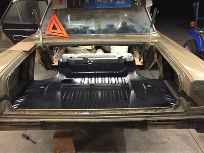

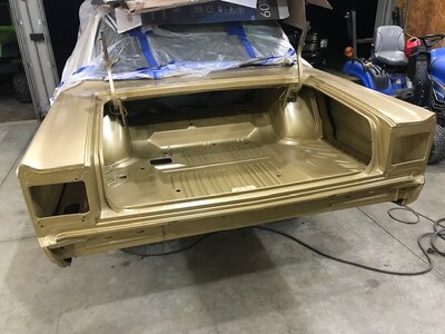

Here are some before and after pictures of when I inserted the trunk pan. A couple things to note though....I put a 68-70 charger pan in my 67 belvedere so I could get the exhaust out the back with a mini-tub. The charger pan doesn't have the tire well so if you took this route you would have to measure to ensure the tire well would clear the bottom trunk lip. Also, your coronet tail lights are not as tall as the belvedere opening....it may be difficult to get the height needed.
While I had the sections out, I put a piece of 1/8" strap steel with studs welded in them to go through the innermost end cap holes. That way if I accidently leaned on the quarter, it wouldn't collapse the taillight area. Those only came out for trial fits but were put in otherwise....right up until I welded the cut out sections back in.

the way you did that was cool... I think if I ever did that again i would try that. Nice work
