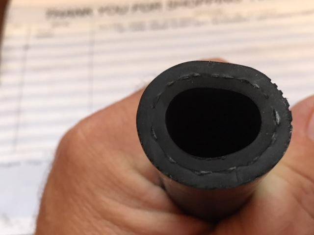

Wow. Has any of you had trouble installing these heater hoses?!
These are way tight and very hard. I just got these through Year One a couple weeks ago. While trying to install on the heater core side, it's so tight the heater core tube actually cuts into the inside of the hose.
I used Ballistol (mineral based lubricant) and I can BARELY get these on. Something's wrong.

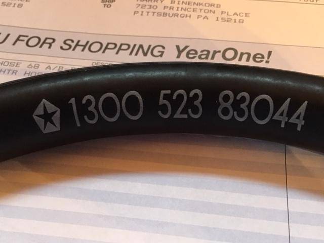

Starting in 1970, the hoses were a combination of 1/2 and 5/8 inch. Prior to that, they were both 5/8". From your avatar, would you happen to be placing these hoses onto the 68 Road Runner? If that is the application and the hose was supplied from us to the vendor in which you purchased it, the label should be listed as part number "HH3". If you can post a picture of the label and the stenciling on the hose, that would be beneficial.

You bought the Year one garbage hose with the too thick wall. I had the same problem, two years ago. There's a thread somewhere on Dodgecharger.com. Get them from Richard (69bfan) or Classic Industries. It is impossible to get them on a heater core without breaking it. I has a side-by-side photo of the ones from richard vs Year One junk. As I said, the wall thickness is COMPLETELY WRONG (way too thick) on the Year One hose. If you have an A/C car, forget it.

Yep, Year One sent me the wrong hoses. I hope I didn't **** up my heater core. They may owe me more than the CORRECT hoses...
You want pictures? Here ya go.

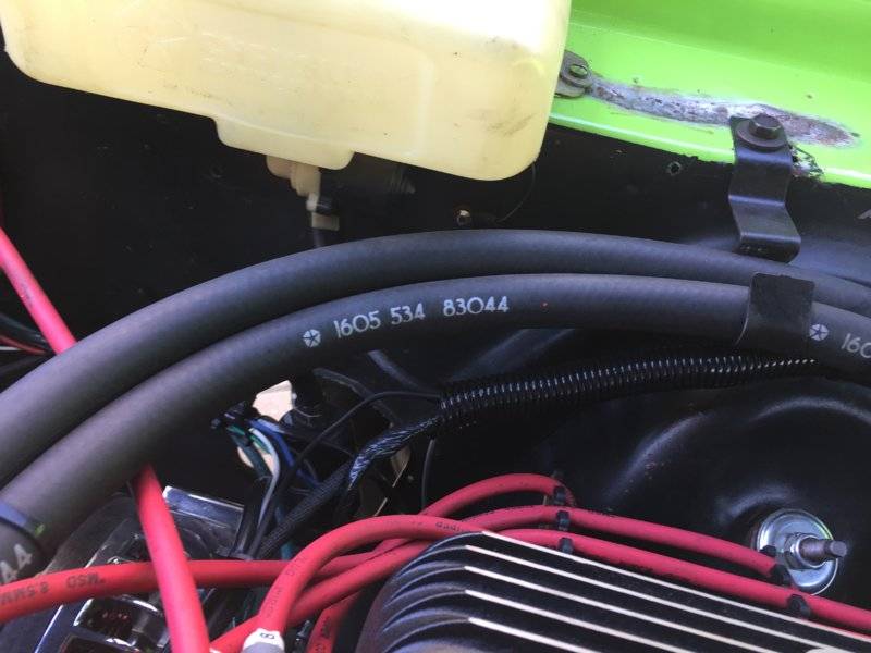

The ones on my '69 Coronet, from Classic Industries.
Then again, think the part numbers might be different again for your '68.
