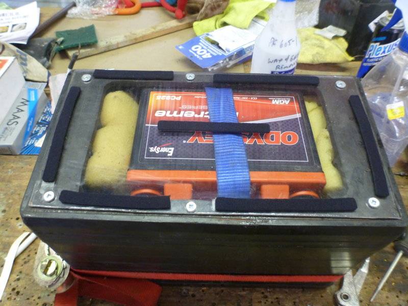

I just gut my old resto batteries and hide lightweight racing batteries inside them. Way cheaper, last much longer and cranks over faster also. I have done 3 like this now.
6PKRTSE I looked up the PC925 battery and see it has a CCA of 330. This is enough power to start a car engine without issues ? I would think you'd need 600 or more. Does the battery die down quick if you need to crank it for more than a few seconds ? That's the issue my resto battery had and I noticed the batteries I side it were made by the same company that makes Odyssey batteries.

The Odyssey 925 is spec'd at 300 MCA in their charts but it actually load tests at 1000 CCA and after 2 minutes under load it barely drops to 970 CCA. I've been using them for well over a decade in all my customers airplanes to replace the lead acids. With lead acids we needed a start by the third try or batteries were dead, on the AGM's you can taxi down the lake on just the battery cranking the engine over..

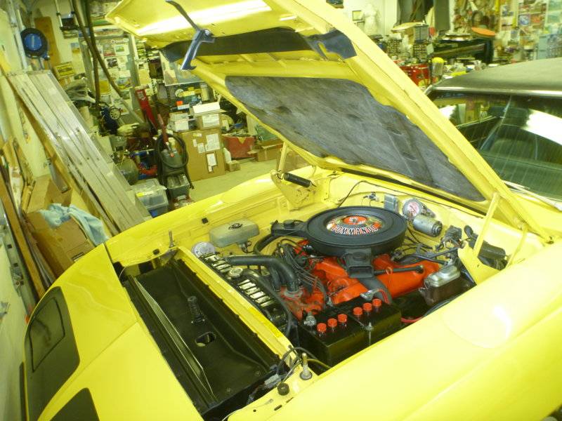

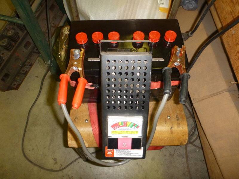

Red top 27 I built for my Bird from a 30 year old case I had that had split in half.

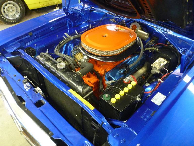

I also bought a script battery about 4 years ago from Antique and it has an AGM stuffed inside it as well. No issues starting my 383HP in my Bee.
