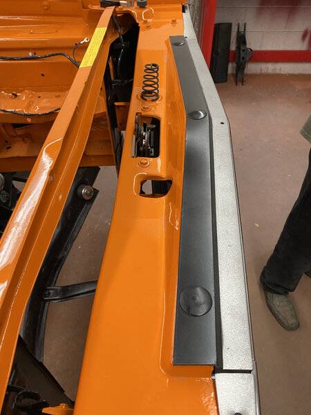

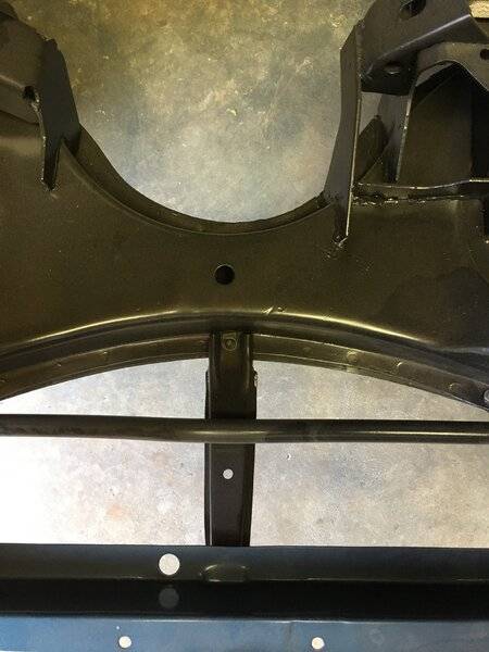

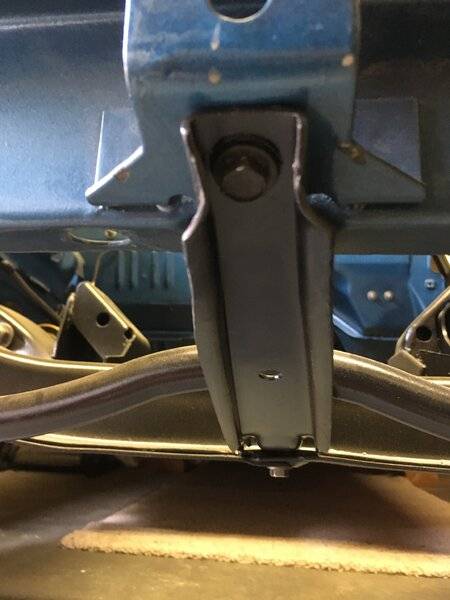

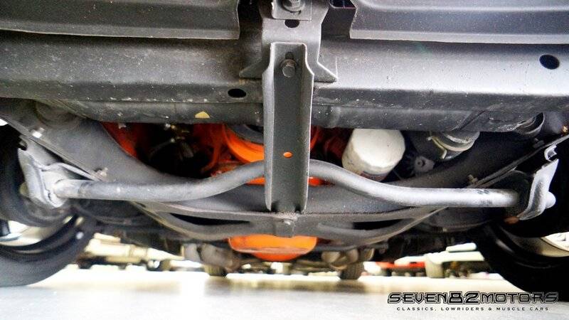

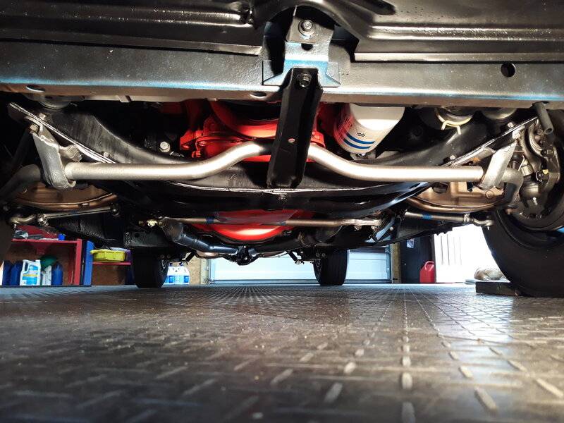

Gentlemen,
I've spent a while today trying to find decent pictures of an installed radiator support to
k-member brace to no avail - so I'm humbly asking for a little help here.
Does anyone happen to have a couple pics of one of these installed in a 66-70 b-body?
(Thanks to @Darter6 , I've actually got the brace now. Thanks again!)
If you can zoom in on pics this might help.
19832233-3D08-4EEE-AA5D-32F89CE96F3E.jpeg 99BF4A50-3B26-4444-ADDA-0A3F574F49DD.jpeg 4B5EC58C-C9C9-4D5F-B14F-02AA6D5ED0B4.jpeg 6155C332-EEAB-4BC4-ADD4-3FE6CBBA138C.jpeg 46691995-5BEB-4D37-A42E-67BA330571F7.jpeg

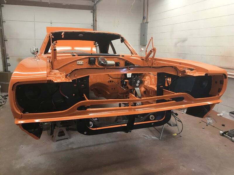

Ed....Hope this helps....Jim
Wow, gentlemen. Excellent pictures, thanks so much!
I was under Fred with the brace @Darter6 sent me today and it became evident in a hurry what the
previous owner had done with the base of the grille support vertical - much butchery and welding
had occurred there, so that hole for the brace is gone and will need re-drilled.
You alls' pics now tell me which way the brace goes and routes in relation to the sway bar, too. :thumbsup:
