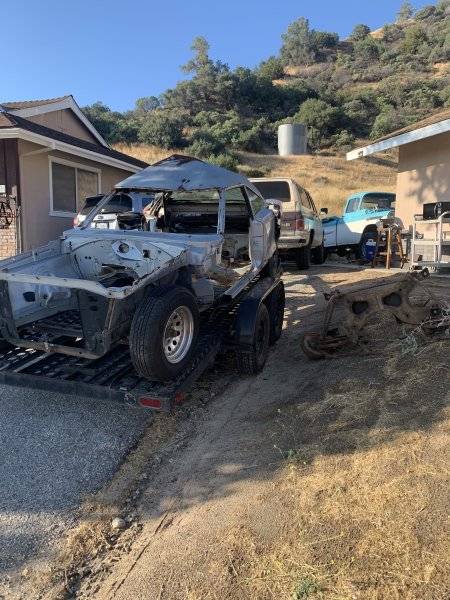

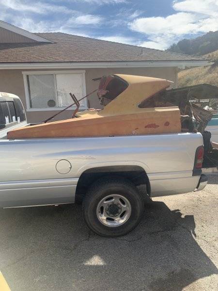

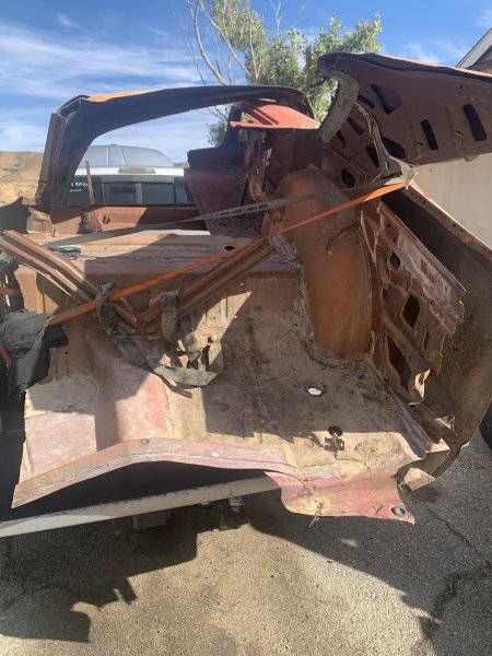

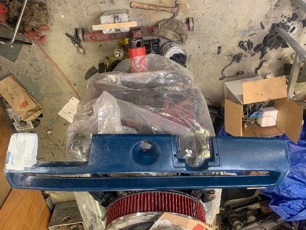

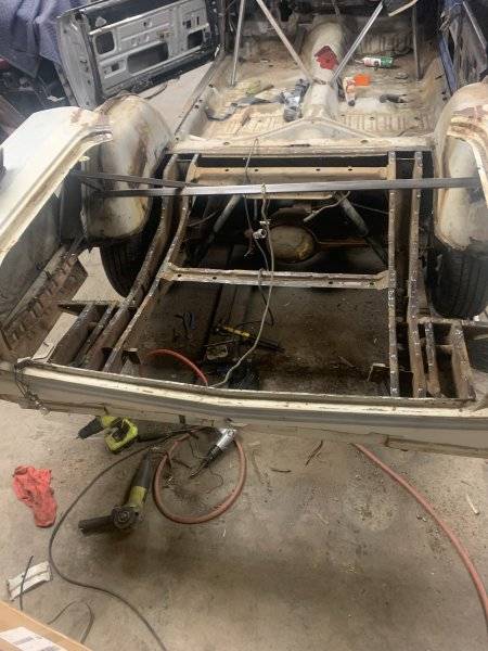

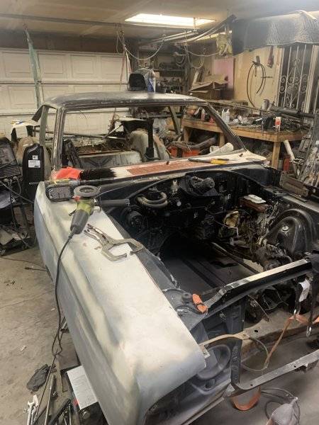

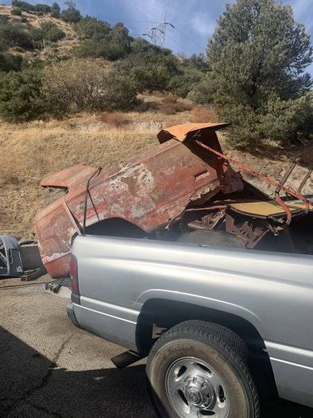

Awhile back I picked up the Roadkill “C-Body” Roadrunner. Over time I have been collecting parts to sort of put her back together, budget friendly-ish. So at this point it looks like we will be around 5-6 cars into getting a driving end product. And so let the havoc begin.

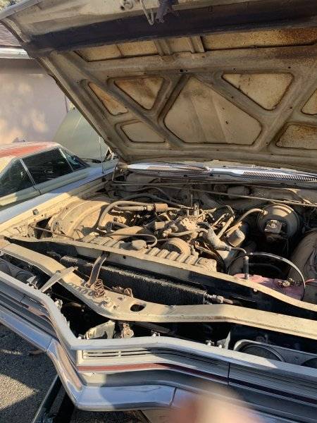

Harvesting the organs out of a mint 300?? :eek: :eek:

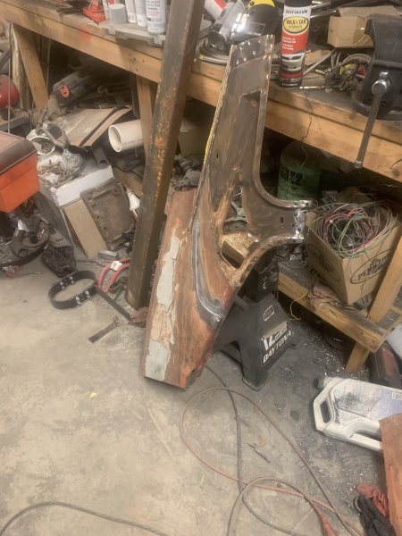

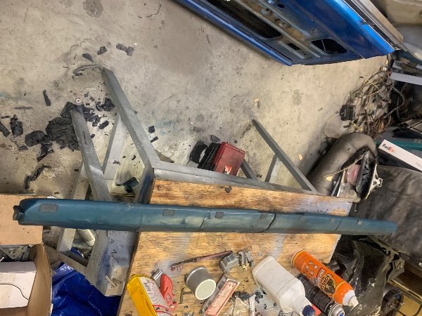

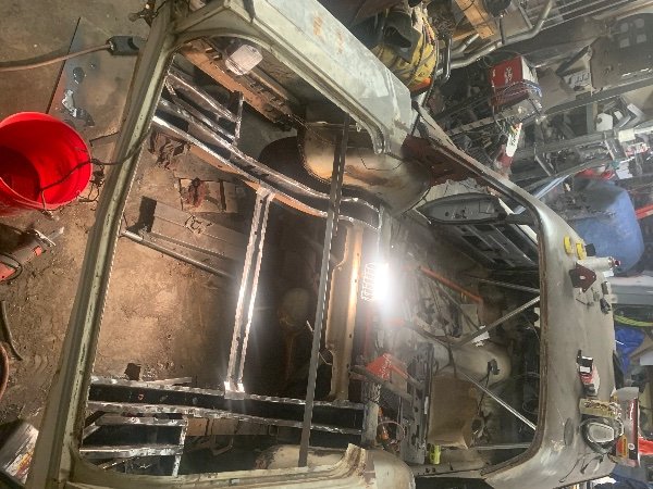

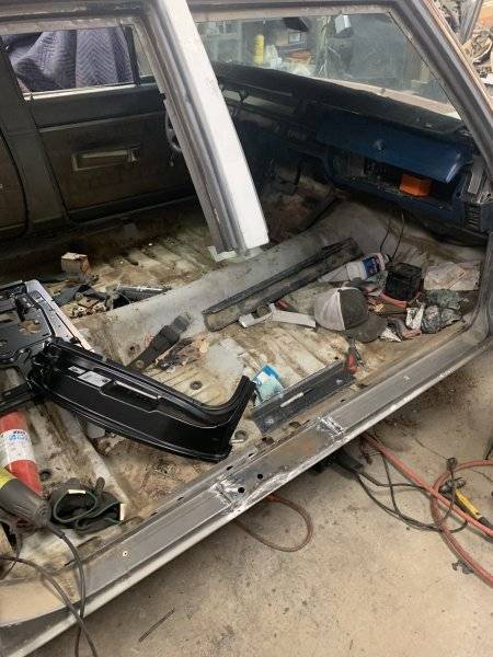

Some of the drivers side inner structure is complete. The rest will come from the RK Roadrunner. But I have to take a bit of a break to fix up my truck so I can get the trunk pan and 1/4’s.
Nice to see another R.R. saved, those donor parts look pretty minty.
very impressive, Chris Birdsong once said "Its just sheet metal sitting on a K frame and 2 rails holding the differential" Easier sectioning good parts than fighting rust. I found the factory tolerances to be "generous" with a flair for seam sealer!

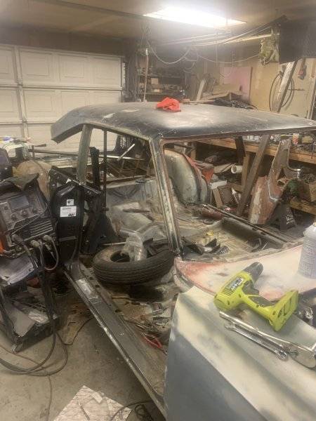

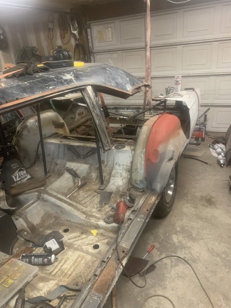

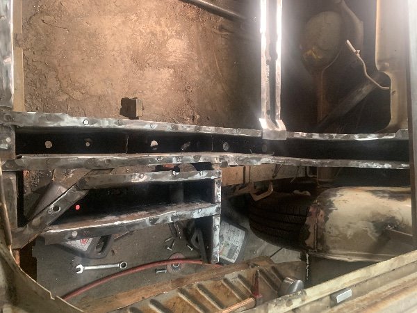

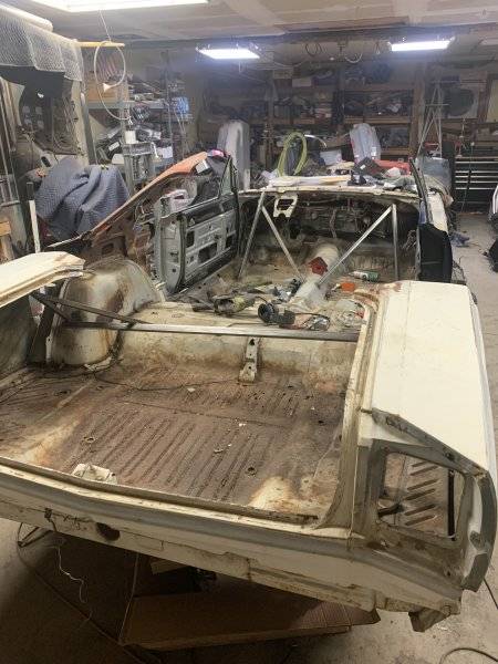

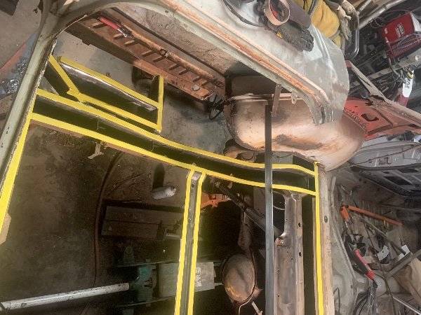

Trunk pan is in, still need to install the tank supports, spare tire hold down, and rear supports, but it’s progress. Slow progress as I have a client vehicle I have to finish before I can really push to get this boy in one piece.

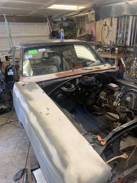

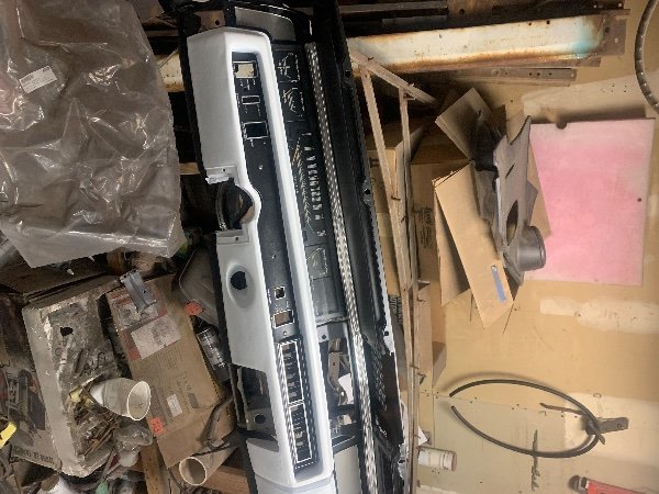

Took a little break from body work, as I have a paying customer to take care of. So at night it’s trim clean up.

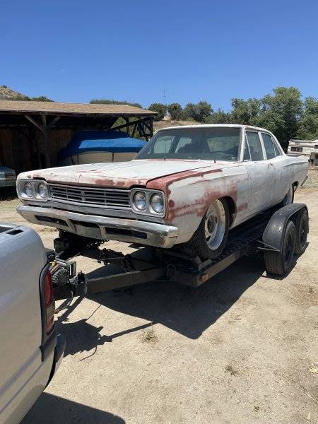

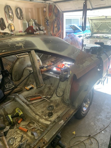

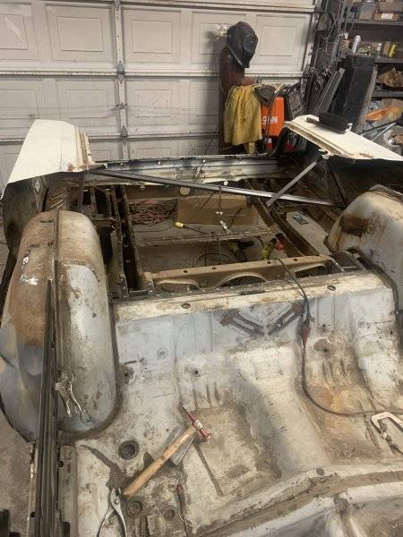

So you are turning a 4 door into a 2 door coupe. What parts are you using from the c body roadrunner? I don’t really see how this is getting the c body runner back on the road.
Travis..

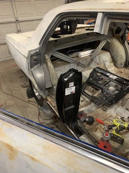

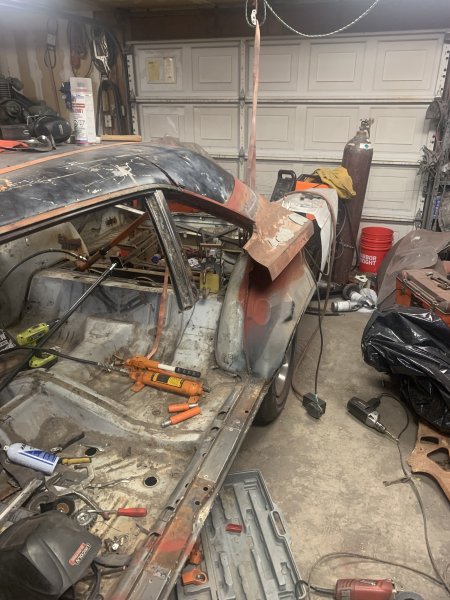

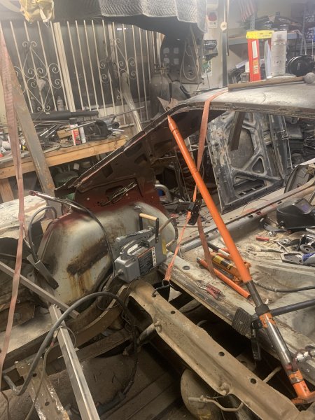

Passenger trunk extension is in and a little patch work on the outer wheel tub. Had to patch the passenger side door, luckily the RK Roadrunner came with what was left of the door they cut off.
