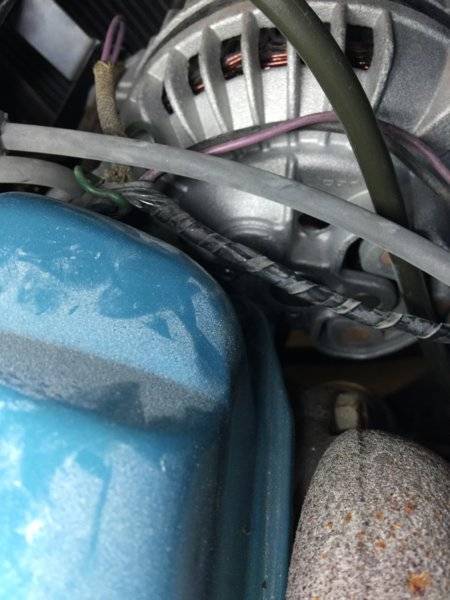

Hello ,put together a 68 383 4spd roadrunner its in primer ready for temp plates ,last problem can't get car to charge only 12.2 at battery with car running or off ,tried to different alternators,changed voltage regulator ,battery is new ,tried bypassing alt gauge made no difference so I hooked gage back up.Also checked fuseable link that goes from stater relay to
Bulkhead connector it also a little over 12.2 volts ,voltage regulator grounded to firewall bare metal. ,have engine grounded with strap to firewall ,negative cable has trace wire grounded to radiator support,car was off the road 10 years before I bought it ,harness is in good shape any suggestions welcome thanks Gregg

Not saying this is your problem, but worth consideration. Don't assume that just because the battery is new, that it is good. Not a common problem, but I have had more than one "new" battery with a dead cell right off the shelf. Wouldn't hurt to test it.
Check grounds could have voltage drop....
Pull the green field wire off at the alternator, turn the key to run. @ measure battery voltage at both field terminals. Now take a clip lead and ground the alternatorterminal.....
Do a output check of alternator..
Do not do test to long can cause damage . Run engine @1500 to 2000 rpm..voltage should increase to 15/16.
a thought only if you have another battery to use and then see what the output is if other battery shows more charge then it could be a bad cell in the new battery. if it shows the same then full field alt and see what output is. if the volts jump up to 15 volts i would say your alt is fine and continune to look. next question is pulley size on alt or other pulleys are they the correct ones. with the car running and you pull the ground wire off the battery does the voltage jump up or drop down. some thoughts i'm sure somebody else can give you a better way or idea on whats wrong
With the engine running, measure the voltage on the IGN side of the voltage regulator and battery - terminal.
You might read more there, which in turn will regulate alternator output down as the voltage is good.
This has nothing to do with a broken regulator, but it can be you have some serious voltage losses in the wiring towards the bulkhead connector and battery.
I had similar issues but mine was overcharging, caused by the fact that the regulator only had 11V on the input side and always kept the alternator charging while it was not needed.
All bad contacts in the wiring caused this and after a good clean up of connectors and grounds it improved a lot.
