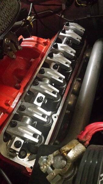

Isky is no longer made. I'm not even sure Crane ductile iron are produced any longer. Two of us on here ordered sets between 2017 and 2018 and the tips wore fast. They were replaced eventually but I wouldn't run any of their newer ones. These were on flat tappet cams with about .530" lift.
I'm currently running the Hughes roller tipped rockers, solid body. They are beefy and have been perfect.

I've narrowed four sets of Isky's, never got a set that hadn't either already been narrowed or didn't need to be narrowed.... I have a jig to mount them on my lathe, easy job, I can do a whole set in 15 minutes...
Did you select the cryogenically treated ones?
