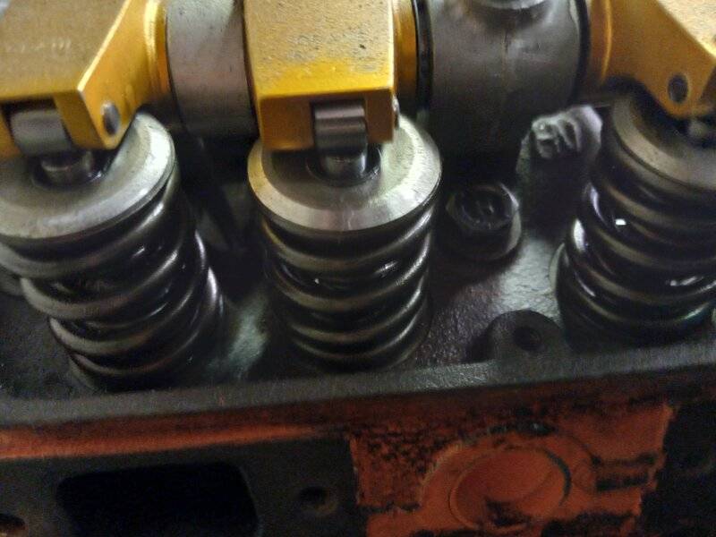

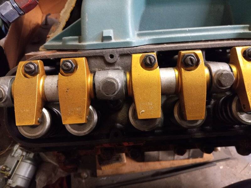

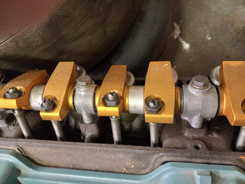

I just put some comps on the 240s.. the outer stands need about .030 knocked off the insides.
The rockers rub on the stands and are too tight if you don't.

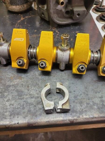

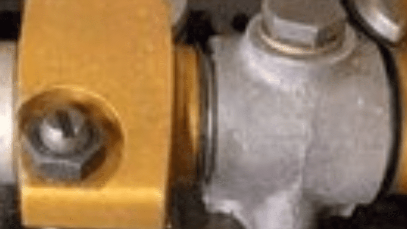

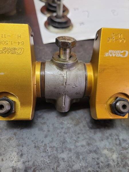

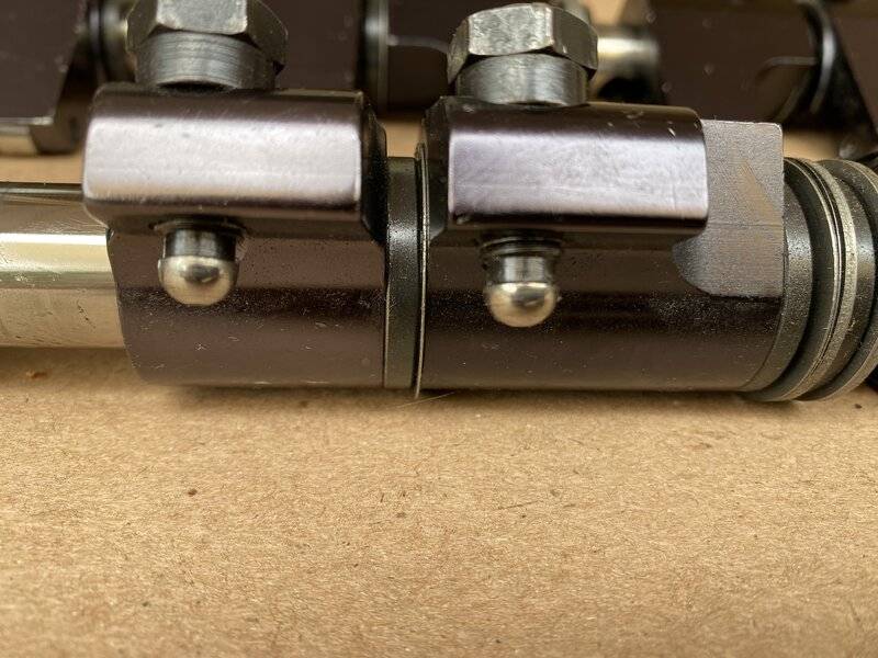

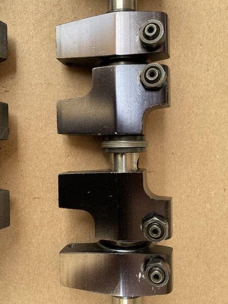

I used the regular crane golds on the aluminum stand maxies and they fit like any other head.
My recollection is the Crane Golds came with some extra little rings/spacers that went between the aluminum stand and the thin shims that rode against the rocker body, to put them in the correct location.
With the cast in stands/stamped hold downs, you didn’t need them.
I don’t have any old factory aluminum stands, but measuring the width of those vs the stamped steel hold downs would provide the answer as to whether or not something different was needed between the two to end up with the correct rocker to valve tip alignment.
Edit- Crane Gold instructions:
https://www.jegs.com/InstallationInstructions/200/270/270-64791-1.pdf
Those are the extra rings/spacers I was referring to:

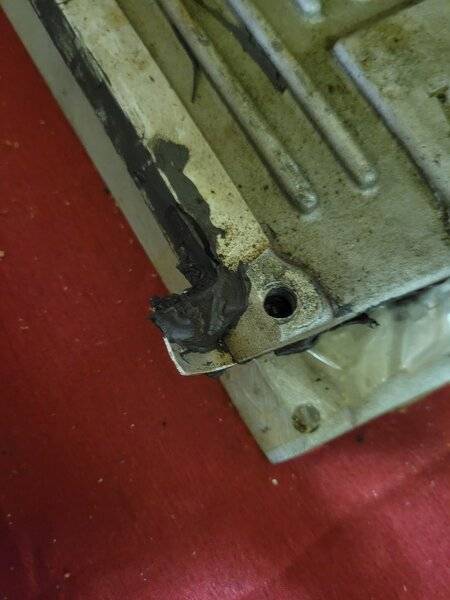

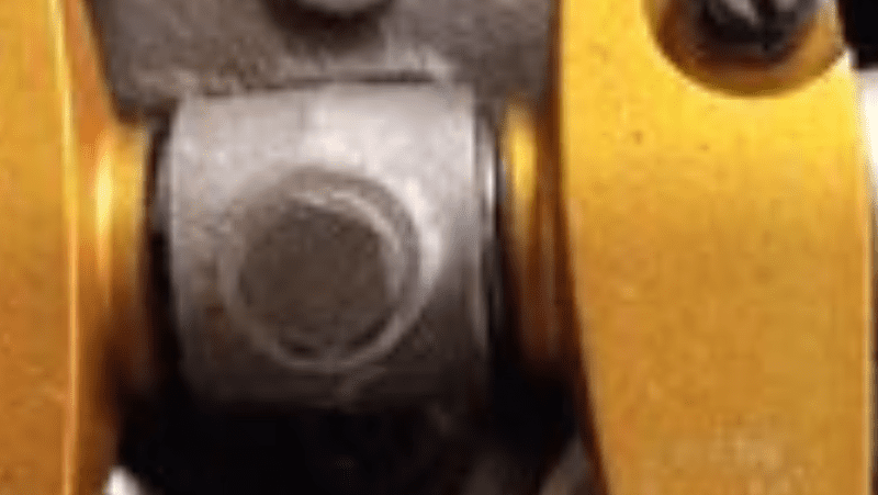

Thank you sirs! Been a while since I since I worked on that stuff. The stand didn't just break ,, that was caused by something else that broke off

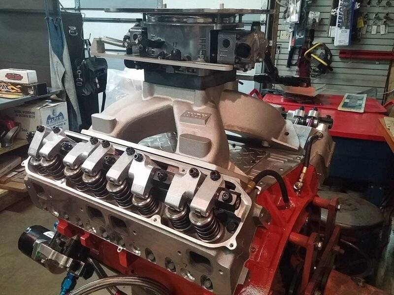

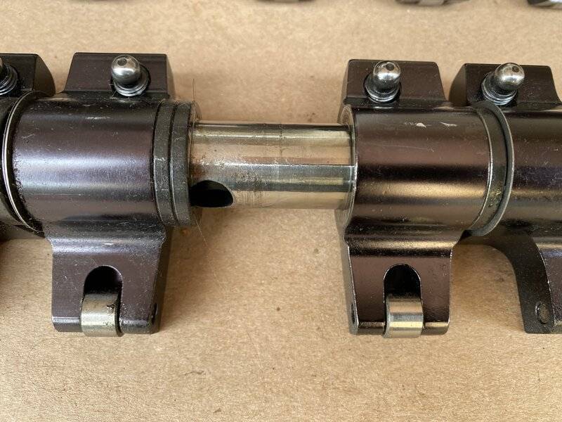

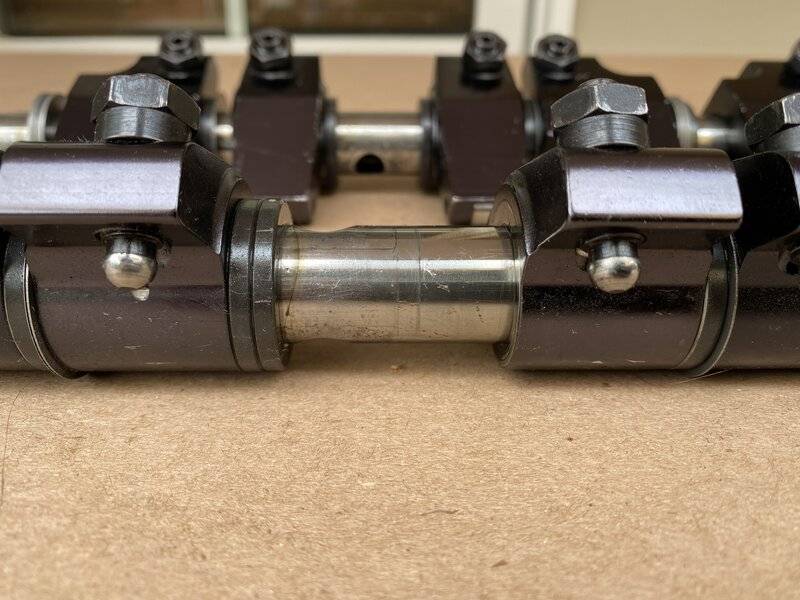

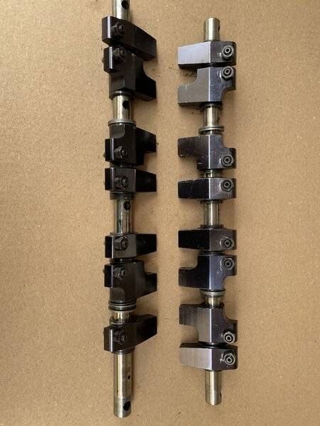

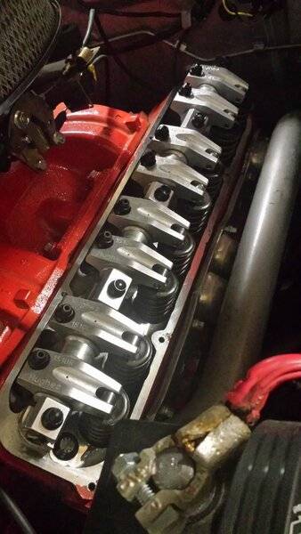

Seems like my Indy rockers are no longer available! My one exhaust pushrod broke apart at the cup and messed up the rocker. So it looks like I need a whole new set of rocker arms. What are some good choices for the money? I know of some of the high dollar rockers, but are there other choices that will work with my Mopar .557?
Ronald,
I'm assuming you are running a -1 style head with an offset rocker. If so, that limits your choices considerably, and none of them are all that inexpensive. If you are going to spend the money anyway, it would make sense to get something like the Custom T&D rockers that we have made to our specs. Don't let the custom part scare you. Until you get done fiddling around with an of the shelf rocker, trying to get things right, you will have the same, or sometimes more money invested in a compromised system. Attached is a pic of these rockers on a -1 headed motor.
Btw, this guy was breaking Indy rockers left and right, too. Now he rarely has to adjust lash.

I'm assuming you are running a -1 style head with an offset rocker. If so, that limits your choices considerably, and none of them are all that inexpensive. If you are going to spend the money anyway, it would make sense to get something like the Custom T&D rockers that we have made to our specs. Don't let the custom part scare you. Until you get done fiddling around with an of the shelf rocker, trying to get things right, you will have the same, or sometimes more money invested in a compromised system. Attached is a pic of these rockers on a -1 headed motor.View attachment 1155474 Btw, this guy was breaking Indy rockers left and right, too. Now he rarely has to adjust lash.
I am looking forward to ordering these when I can. I have had enough valvetrain instability to last a lifetime. Just wish I had something like this years ago.
