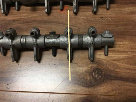

So, the way I read this is..... if I want to bad enough, it can be done. I would just need to machine the rockers narrower, maybe modify my aluminum stands, and machine some custom spacers. Piece of cake.
You'd have to tweak the rocker sideways.. or haha maybe just re-locate the valves...and if you had the ultimate "T.V. repairman" set of tools I bet you could spread the cam lobes and lifter bores out a tad:D:D:D

As for the 273 rockers on a BB, along with not having any offset, I think you’re going to find they are too short.
Easy enough to tell by putting them next to each other on a shaft.
