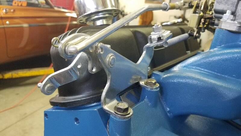

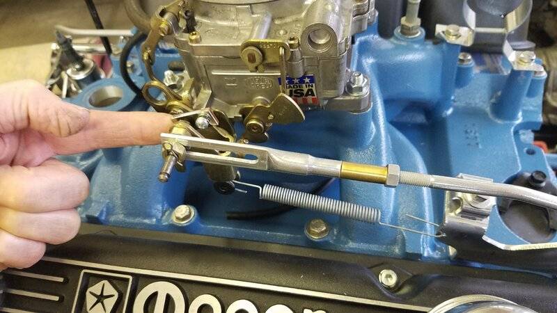

I modified the stock kick down to work with the Magnu the rod extension was a piece of brass 1/4" pipe tapped internally. Used a piece or threaded rod to connect it to the original link, making it longer. Then a small tab to extend the cable ( my finger is holding it up).
Doug

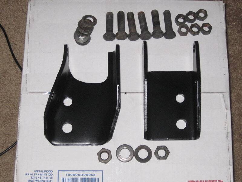

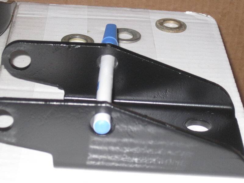

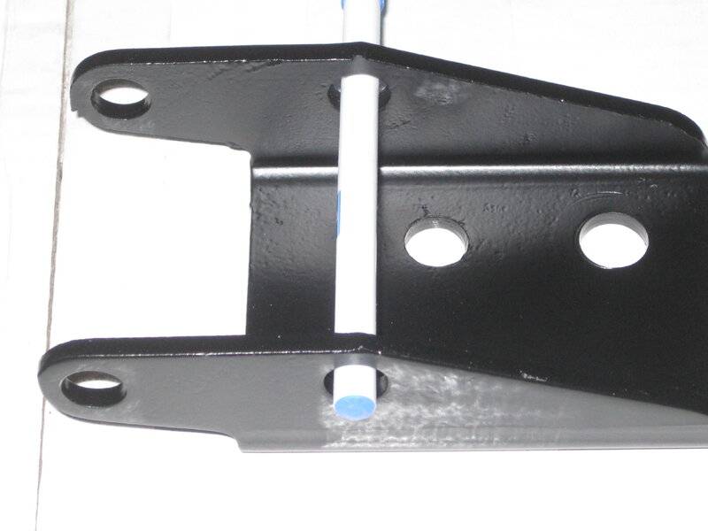

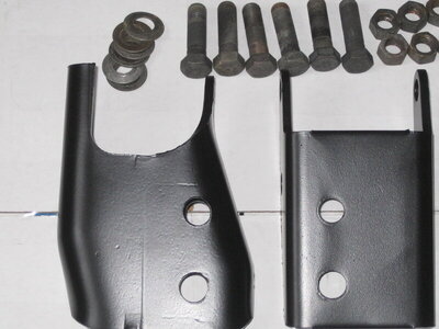

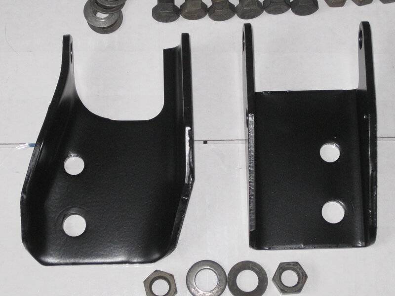

B-BODY 273 mounts will work on a 360, on the pass side you have to drill 1 hole straight across from the pair of holes. on the drivers side you can get by with a washer stack of .370 around 4 thick washers. here is the 273-318 b-body style mounts you should have
ok here is the passenger side mount with a pen going from a factory hole to the other side of the mount with the hole you should drill to bolt up to the block

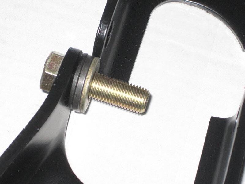

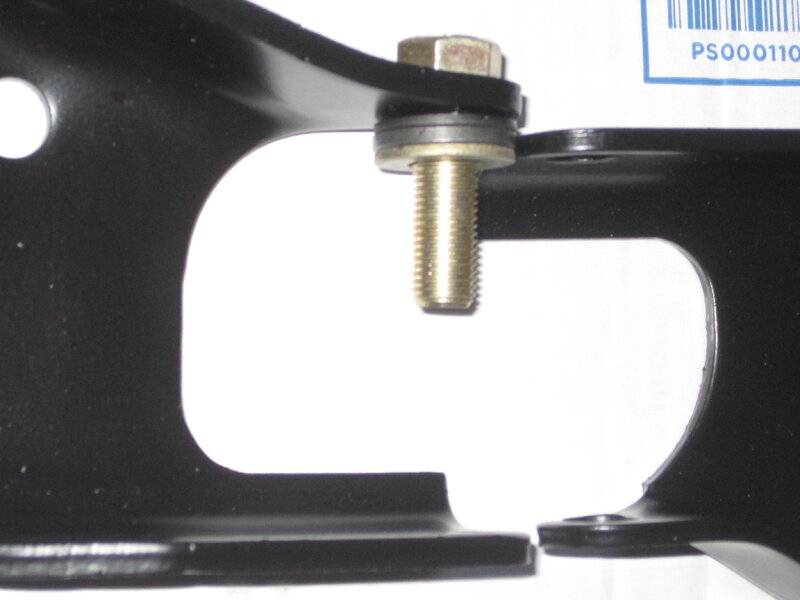

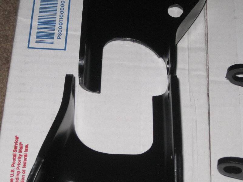

ok here is the drivers side 273-318 wide mount and a 340-360 narrow mount showing you the exact amount needed to shim or make a spacer for as the 340-360 has a narrower boss spread
