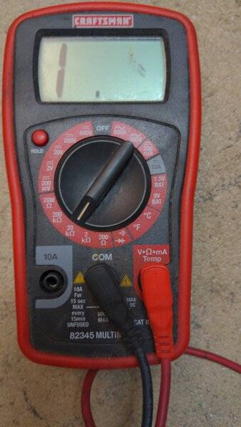

It is 11, but on the 20k scale, so that's 11,000 correct?
My spiral core measure 1-2.5 in this scale and the suppression core measure 11.
To be clear that photo is just to show the setting, it's sitting there open not measuring anything
