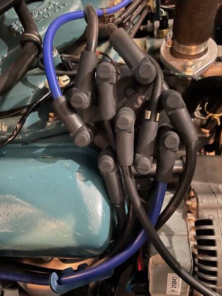

I just installed the Hyperspark on a 383. Stock 906 heads though. I did not have to clearance the heads or valve covers to make it fit. The edge of the cap is very close to the valve cover but not hitting. I'll take a picture of the setup when I get back on it.

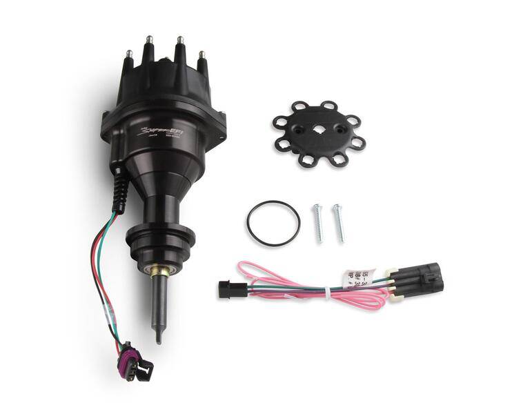

Mopar Performance Black wrinkle valve covers just to let you know the setup. Let me get the hyper spark number I used. I believe this is the one I installed. Also using the sniper to control timing. The distributor comes with a clear cap to phase the distributor. Pretty simple setup to be honest. I don't know about stealth heads. I would assume they are called stealth because they have the same look as a stock head? Anyhow the part I used is below.
https://www.summitracing.com/parts/...qGApEm0I1qh6HIFd3NZJz1g9UDuKn4LRoCIcgQAvD_BwE

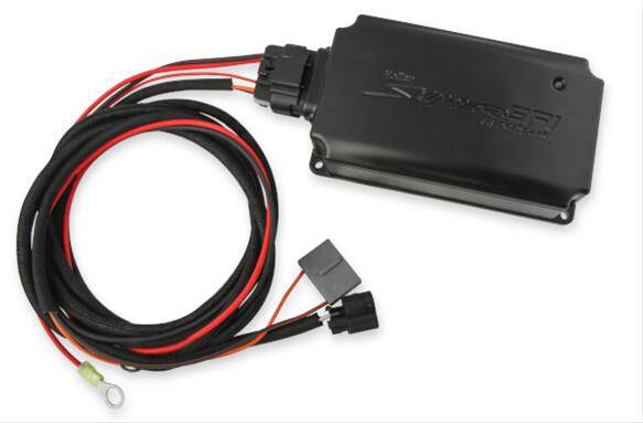

Used this CDI box.
https://www.summitracing.com/parts/sne-556-151

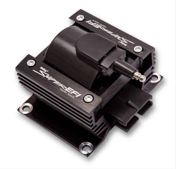

And this coil.
https://www.summitracing.com/parts/sne-556-152

I use the Hyperspark distributor on the 383 in my Coronet with stock heads. It fits, didn't have to grind anything. Stealth heads are a copy of the stock heads so that shouldn't be an issue. I am using stock valve covers but I did have three different sets of aftermarket ones on there previously and I didn't have to mess with any of them to get the distributor to fit.
The Hyperspark is basically an MSD distributor with slightly different parts inside. The cap even says MSD on it. If you want to control timing (you do!) don't even think twice about it.
Excuse the blue wires, had some get burned on the headers.
With aftermarket valve covers.

I would say Hyperspark, no problems with mine. Even I managed to set up the Hyperspark distributor correctly and if that's the case, anyone can.

Where did you install the 556-151?
Also where are you getting power from?

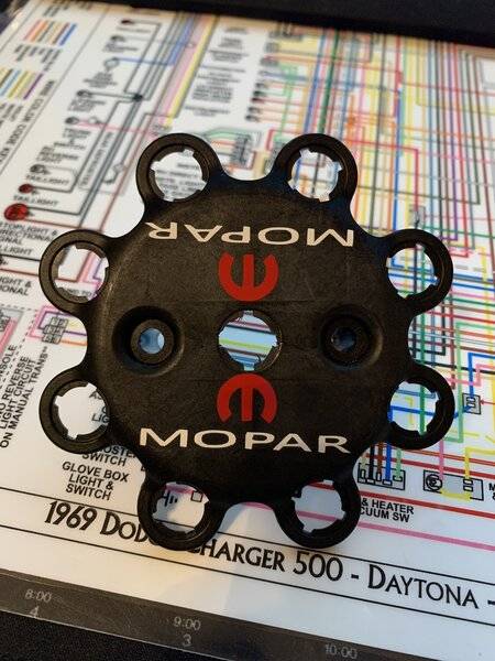

I customized my top retainer.
