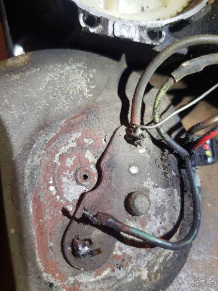

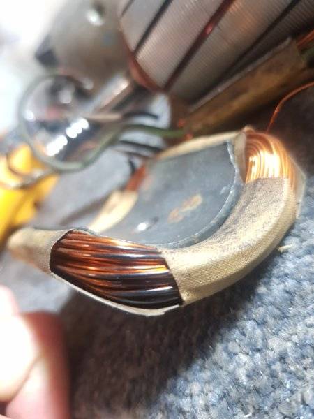

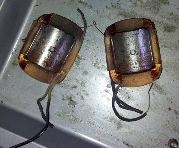

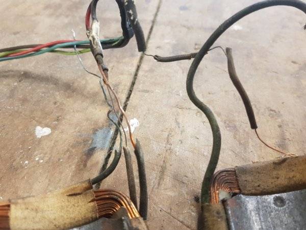

Everything seems pretty good. Except for the winding sheathes. Having trouble locating something to replace them.
Anyone know anything in particular i should be looking at?

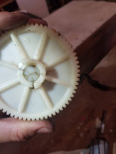

The motor gear has some spider cracks through the guts of it but nothing to bad. The outside looked worse then the inside. Brushes dont look half bad either.
Any tests i can do on the windings?
I remember seeing a post with a few procedures i just cant seem to find it now.

I did find some heated windings after a little cleanup yesterday.

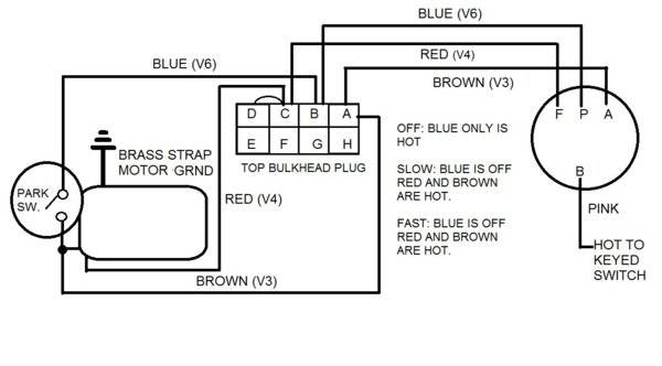

If it is a two speed with a three speed switch,I have a simplified print I made about how it worked with a three speed switch when I serviced mine.
(This is for a 67 wire colors probably are right for you)
I've got "how to "pictures but I don't know if anyone really cares about that.

No its the opposite. 3 speed motor with a 2 speed switch. Thanks for the schematic. It will come in handy

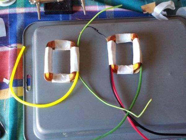

I repaired mine with some heat resistant 1-2mm fibre glass sleeving. Also got hold of some winding tape to keep it all together. I've got plenty left over if you want some. Should be able to wrap some tape around a dowel or something to get that to you as well if you like.
The second pic with the bright colours was before i got the fibre sleeving. I tried out some computer sleeving but it was way too big. Also had to re-tape because it wasn't tight enough. By the time i got the proper sleeving i was better at taping it together. I had to join the windings at the base because it broke. That pic obviously isn't the end result. it turned out a lot better than what you see there but i didn't take a pic unfortunately. Ran it on the bench (kitchen table) for an hour on high and low and works fine. the red paint is winding lacquer. If you're interested in the sleeving and tape pm me your address and i'll send you a few feet. I'm in Melbourne by the way.

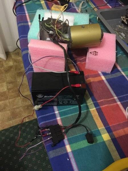

Here's a test procedure for when you're done. Found it posted by someone doing the same thing a while back.
Test #1(Hi speed)
Connect jumper wire from motor case to battery ground.
Connect second jumper wire from battery positive to BROWN lead.
Motor should run hi speed continuously.
Test #2 (Lo speed)
Connect jumper wire from GREEN wire to battery ground.
Join BROWN and RED wires together and connect a jumper wire from battery positive to them.
Motor should run at slower speed.
Test #3 (Park)
Connect jumper lead from GREEN to BROWN wire.
Connect jumper wire from red wire to ground.
Connect jumper wire from Blue wire to battery positive.
Motor should reverse and park.
(Depending on where the motor had stopped the park feature may have a full rotation or very short rotation
