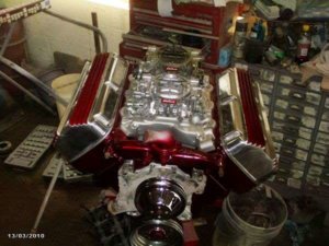

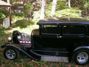

I'm not sure of the factory redline, but I just sold a model a ford with a 354 solid lifter motor and 4 speed. I regularly spun it 6500 with no problems. stock crank and rods, good rod bolts, egge 10-1 pistons, and adjustable push rods
here's a couple pics
Thanks Crider. Modern cam and springs? I think even the stock stuff might have been good for 5500-5800 but that's just a guess.
Modern springs, New old Isky cam
