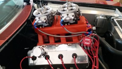

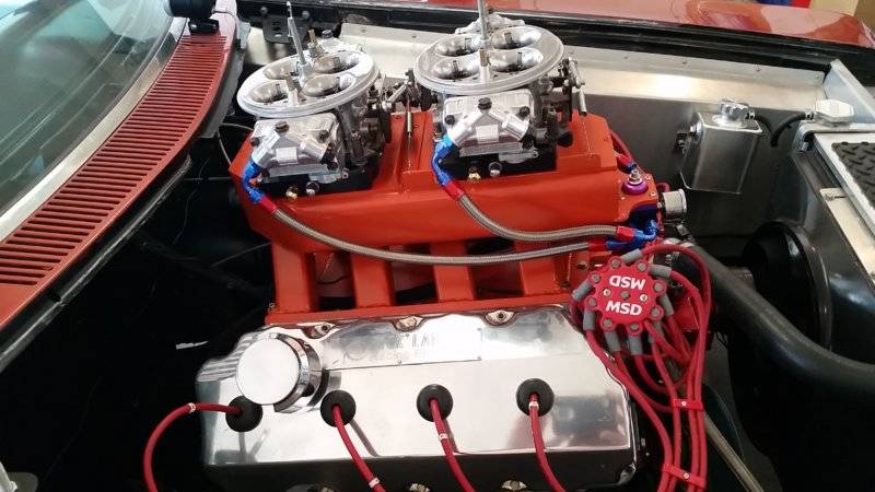

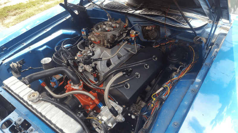

1st picture is my motor but 2nd picture shows a nice Hemi with the Ray Barton Single Plane intake and a BIG Dominator (plus I think there is even Nitrous on that setup) plus looks like it has a vacuum pump setup.
