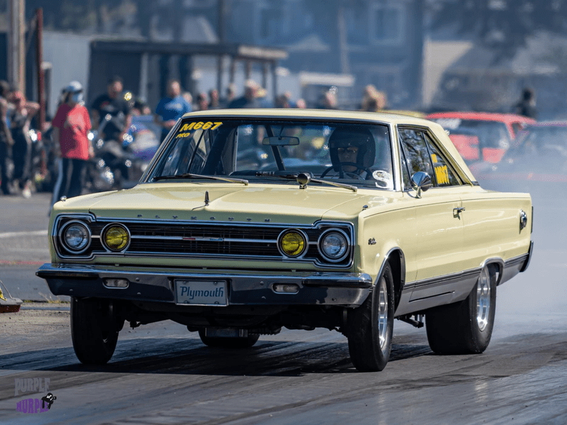

Well, although I am yet to get the intake swapped over (existing RPM to an M1), I made some solid passes today and I think the changes are in the books. A few weeks ago I was handed a time slip that said 10.87. The incrementals just didn’t add up and I didn’t know what to think. Well, we saw some solid passes today and will chalk the 10 second time slip up to timing system error. With that said, the car went back to back new bests today @ 11.107 & 11.100. MPH was also a new best at 119.9 (knocking on the 120MPH door!!!). The short time on the slip was also a new best at 1.52.
thanks to all that have followed along with me this past off season here. It was a lot of work, but I’m happy with the results.

Good news all around. Your 10 second time slips are going to become a common thing. You’re going to chisel those 60’ times down lots and you’re already into 10 second ET’s with your speed. Thanks for the update LW, it’s been interesting to follow your off-season updates and progress.
