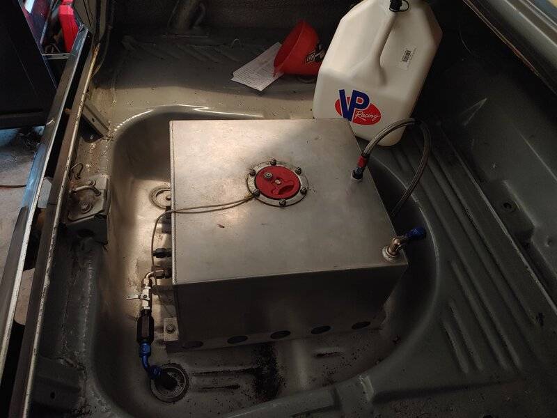

Just throwing fuel cell picture out there
