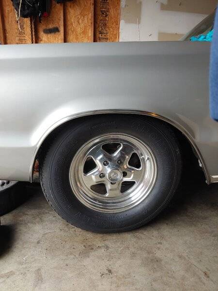

I know you mentioned running 29.5 10.5 MT and a 27 inch front tire here's mine 1 using a 10 inch rim and the other with a 12 inch rim and also how mine sits with a 28 front runner. Good luck my Fab guy used the US cartool kit on mine and didn't move rear axle back

I can fit the 29.5/10.5W tire on a 12 inch rim, but right now I just have a MT 28x10.0 with a 10 inch rim on the car now because of being cheap . the rpm isn't bad with that 28 inch tall tire and 4.30's

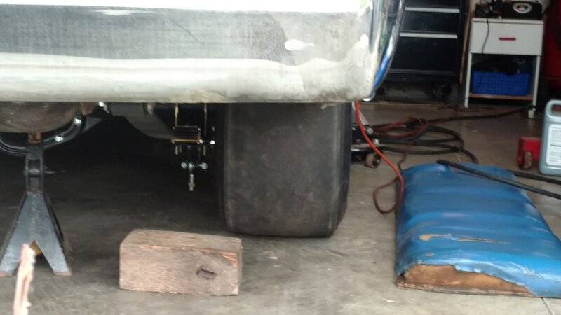

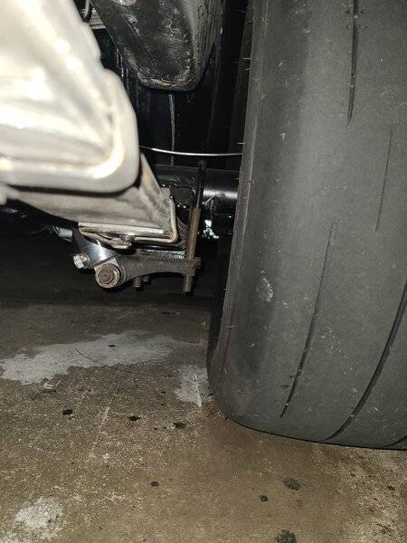

A picture from behind with the 29.5x10.5w tire with 10 inch rim.

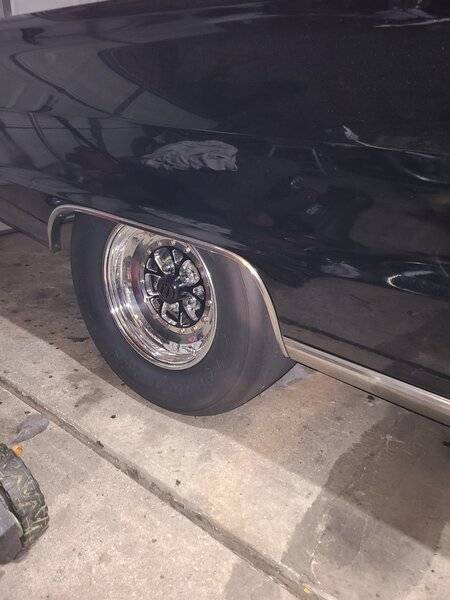

Your going to at least need 5.5 bs to fit 295 60r 15. You might want to try getting rid of the hump on outer fender. My wheels don't have that huge dish to them. I thought they would have.
