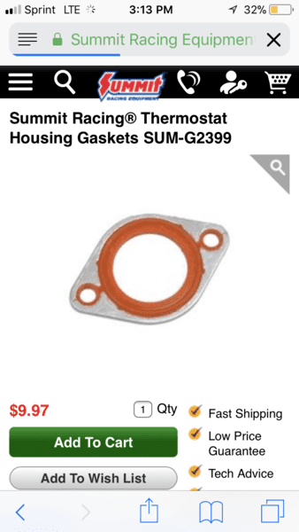

Something so simple as a thermostat gasket

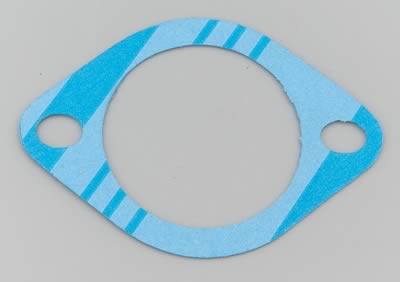

    Fel-Pro is what I use, no sealant.

              Felpro's been working fine for me for many, many years. I'll waste my money on other things!

                    Thanks for all of the replies. I've noticed the car presently has a large amount of RTV around the housing and gasket. It's not sloppy, but looks as if they were very generous with the RTV during the install. Seeing this, I will spend the $36 and take Dennis' advice for the billet housing from Mancini. It's a small price to pay for perhaps one less simple headache.
