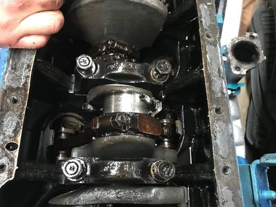

Here's what the noise was on my engine at the front. I'd pull the pan.
I hate the thought of dropping the pan with the motor still in the car. Hate the thought more of pulling the motor again. When I did the stethoscope this morning, I heard nothing with it underneath on the block or the oil pan - only when I probed the timing cover - nowhere else. It HAS to be something simple. I can't see brand new bearings sized to the crank and caps - professionally - going bad like this. This was a professional and very reputable shop that I took it to. The owner is in business for 30+ years. when we assembled the engine, we used plasti-gauge for every rod.
