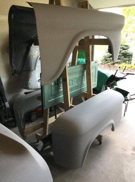

To safely store body parts when I built my ‘58 Apache, I made an A frame cart with casters. It was easy to move around which was important given the limited space, and prevented stuff from being scratched and dinged…
That's the ticket space saving thanks.
