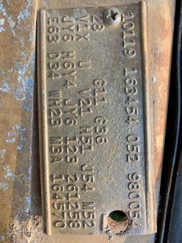

I have come across this 73 rallye which appears to be a oddball? 400 2 barrel? Sunroof? AC, and although the tag doesn't show it, it has factory cruise control. This is a pretty odd combo isn't it?

Is there a build sheet to show it actually is a Rallye? Besides the loaded options, having a 2bbl would be bizarre.

Wh23 with the j54 performance hood and v21 performance hood treatment make it a rallye as far as I know

althought it could be still WL21 and still a Rallye with those codes.Rallye package was optional to hardtops and couples the same.
All Engines but /6 were optionals with Rallyes, including LoPo. 318 which it was 2 bbls was the standard engine in fact.

Nacho....I thought Rallye's had the A57 on the fender tag do designate as a true Rallye car.
There is no A57 on the fender tag. A57 is a Rallye car. Also Rallye's did not come with 2bbl's. Something is fishy on this one.
OP's pic is a Lynch Rd tag.
WAY less coding on LR tags.
I've also seen the hood not coded on a rallye but the hood stripe coded.

there is no way to get J54 and V21 codes if wasn't a Rallye
I saw those and though the same thing. I guess I'm thrown because I've never seen a 400 2bbl Rallye. Yes, other small block 2bbl cars, but never a big block 2bbl. I'm still curious if the build sheet exists? That is quite a car.

as being said, is true A57 is the code for Rallyes, but Lynch Road cars ( and this is the case ) didn't use to code packages, just equipments from packages separatelly ( and sometimes not all of them )

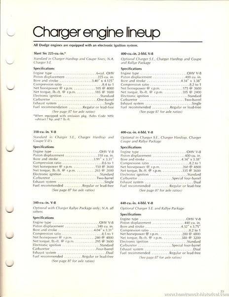

and yes, 400 2bbls was also available on Rallyes
The numbers I have for WH23 73 Rallyes are 6019 total production with A57. But no break down on 2bbl cars. 5544 account for 440(U), 400-4bbl(P), and 340(H). That leaves 475 for 318-2 and 400-2 Rallyes. There was only 556 WH23 sunroof cars of the total 45,415 WH23 Chargers in 73 so this is a RARE one.
