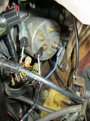

I installed the tach harness today and hooked it up blue wire to power and other to negative side of the coil and plugged in the clock plug. When i went to start the car it wouldn't start no spark then i disconnected the coil wire from the negative side and the car started right up. Any ideas why?
If you are sure the tach is wired correctly then the tachometer must be shorted internally. Is it a known good tach?
I don't know if the tach is good i just connected it and thats what happened i guess i need a tach now

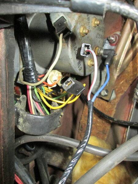

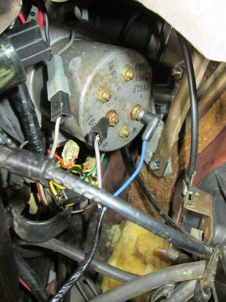

Did you wire it the way I showed in the picture? Blue wire on top? Where did you run the blue wire to for a power source? Also on the tach where the gray wire goes is there an insulator on the terminal? It can not ground to the case. Make sure the gray wire is not pinched and grounding out. If you see nothing wrong with the car running touch the wire to the coil and see what it does. Post some pictures of the tach.
I ran the blue top power wire to a fuse in the fuse box ill take a picture of the back of the tach

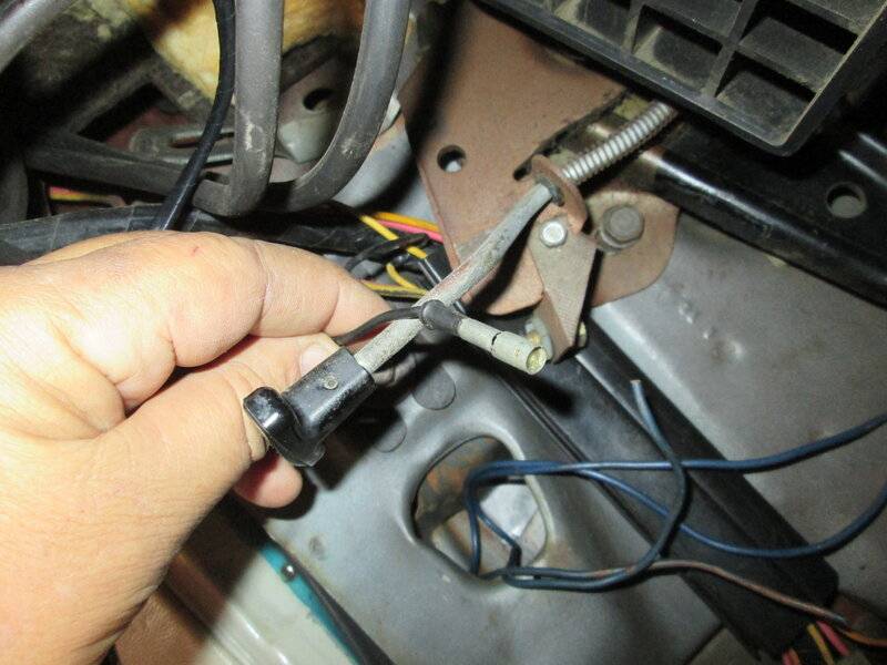

This is how i have it set up. The 2 yellow wires going into the plug i don't know what they are for and theres a black wire coming out of the kick panel i don't know where it goes. My fuel gauge isn't working, my taillights and parking lights dont work. When i put my flashers on my dome light and console lights flash very strange.
The black wire by the kick panel is for your parking brake switch.
The two yellows together I believe are for the lights left on buzzer when you open the door.
Tachometer looks to be wired correctly. Hook it back up at the coil. Unplug it at the tachometer and start the car. While running try to plug the wire back on to see if it kills the car. If it does it is either the tach itself or something grounded on its internal wiring. What is the tachs history?
