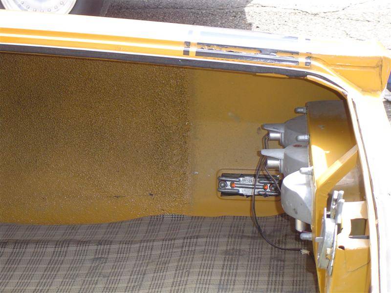

The attached picture is from a 5600 mile survivor. Ignore the gold finish, the entire car was Ziebarted. Further below is another without the Zeibart.

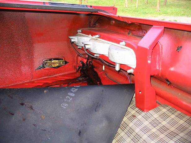

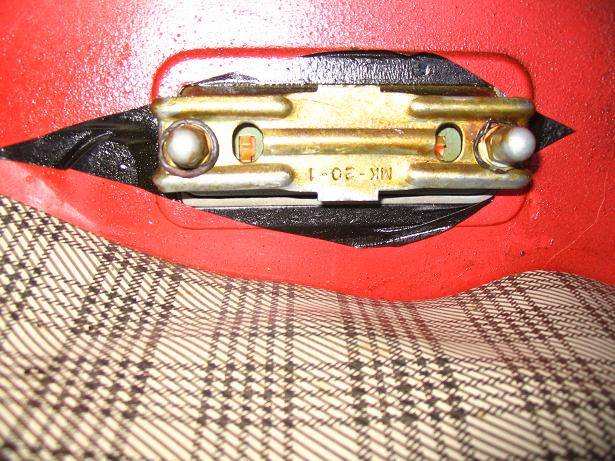

This is another survivor without the Ziebart. The tabs of the stripe have crumbled or tore off over time. It should look like the above stripe cut detail. It was very random, just an X through the opening and folded over.
THANKS!!!! so much, so just Gray primer on the back of the bezel and stripe colour on the outer?
It is actually a greenish color if want to be spot on. The top picture shows it if you look through the hasp. The gray you see is the body gasket peeking through on the edges.

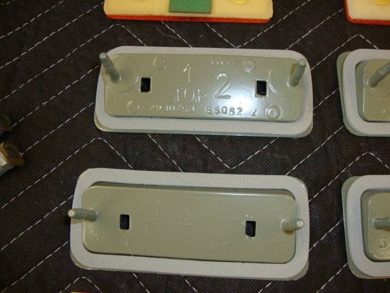

They were never painted on the backside with the exterior color.......The greenish color I found a perfect match for.......

J,
Can you post a picture of the rattle can color you used if that is the case?
