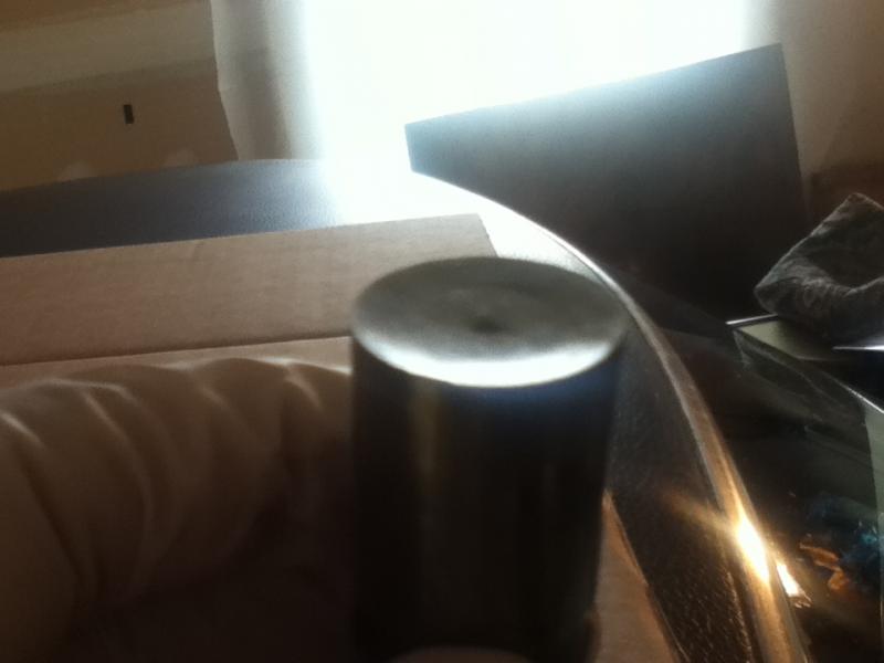

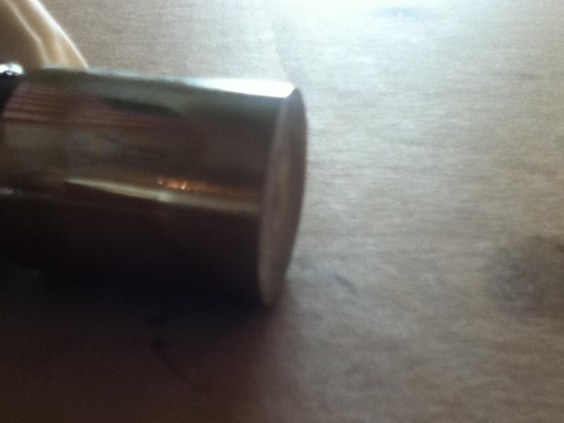

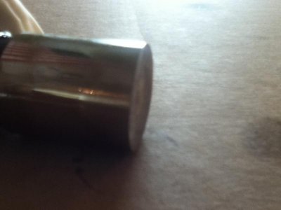

I pulled the lifter. Damn. The bottom facing the cam has become concave...I don't even KNOW how the hell that happens...and there was a slight ridge around the edge. It didn't just slide out easily. Yes, I know. Bad news.

Time for a new cam and lifter and to be honest you probably want to look at a few things closer if you keep having flat cam issues with proper break in and lubrication zddp levels etc..such as coil bind, retainer to valve stem clearance etc etc. The valvetrain can drive you nuts if you arent careful.

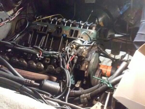

Yeh...I've never done a cam before. Plus I've got the a/c system to contend with/get out of the way. I know it is possible to swap the cam without removing the motor....but I've never done it before, so I'm a bit hesitant. I gotta do it though.

Yeah, A/C can complicate things, but you have no choice mate.
You already have intake manifold and valve covers off. Now it's just radiator, ancillaries, water pump and timing case cover...

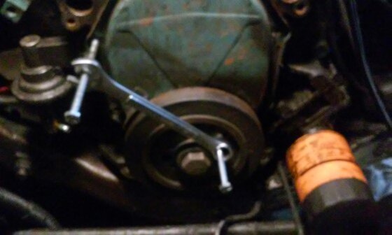

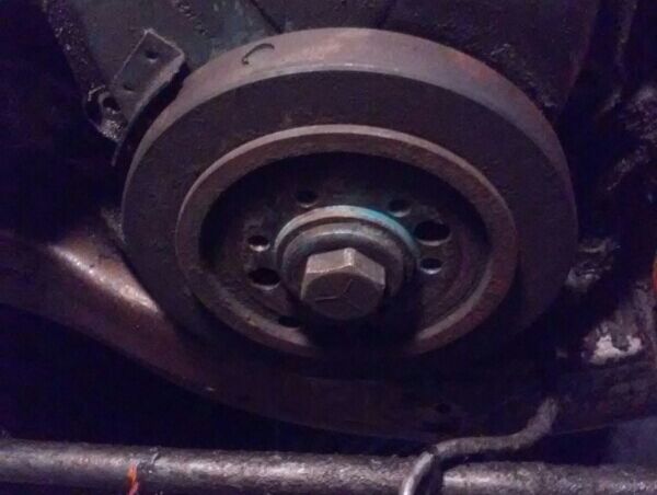

Well I am still around. Life gets in the way priorities get shuffled around.......lates: I am trying to remove the harmonic balancer. The damn bolt WILL NOT budge....also Any tricks to keep the motor from spinning? I've tried everything BUT putting a screw driver between the teeth of the flywheel and transmission bell housing. YES, EVEN I am smart enough to say "but won't that break the teeth on the fly wheel"...sheeesh. Oh..and that wrench is just bending that top screw because how stuck that bolt is. This is what's holding up EVERYTHING..I'm trying to get to the camshaft. Any wisdom would be of help.
