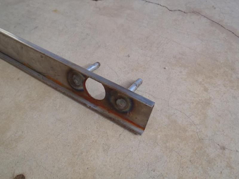

I wouldnt bother renting a cordless impact. That probably wont budge it. I dont know how crafty you are, but you could make a tool to fit in the balancer to hold it so you can break the bolt loose. Like this

That looks like an awesome idea. I would def make something like that. I am somewhat crafty but lack a shop or welding tools. I have my garage and some tools and that's about it. I guess I'm not as well equipped as other guys around here, well actually I know I'm not, lol.
You wouldnt necessarily need to weld it. Drill 2 holes through the bar, and just nut and bolt a grade 8 bolt as big as will fit in the holes in the balancer.
listen to BeatersRus, I done his trick many times, it works
