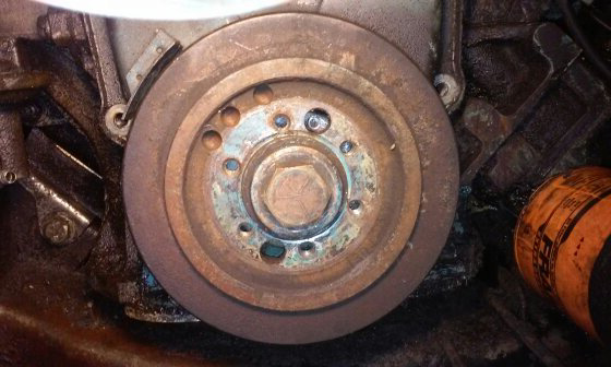

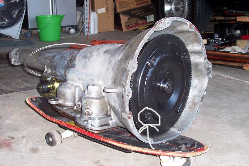

Thanks '69Bee....I just wanna be sure....this is where you talking about threading grade 8 bolt into? I've never been into the transmission..not that familiar with what is where...FSM isnt that clear...flex plate is bolts?

It's similar but to different to do the way I did it. I failed to read all comments to realize it was an automatic. If the tranny is off, is there a way to secure the flex plate? The torque on the bolt you are removing is 130 ft/lbs. there should be, I believe 6 bolts holding the plate to the crank. If you can remove that then put 2 bolts 3 inches long then use a long extension to weave in a position to create some leverage. Imagine bolts coming straight out, extension will be on opposite sides of each bolt and perpendicular. Let me know if this helps.

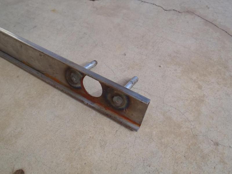

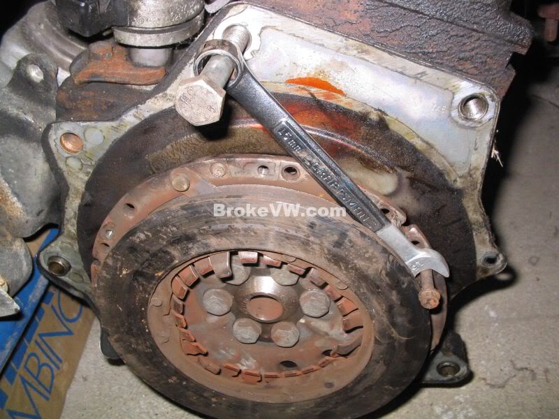

No problem. No, the transmission is still in the car. Yeh, I knew the crank bolt is on there pretty good. I've just about tried everything (except the air gun, which I don't have). I tried putting a wrench between bolts, one threaded into the block and one into the face of the balancer. The one bolt threaded into the block began to bend as I pushed the breaker bar over. (the pic is just representational, not mine). I REALLY don't want to jam a screw driver between the teeth of the flywheel (yea someone has suggested that).

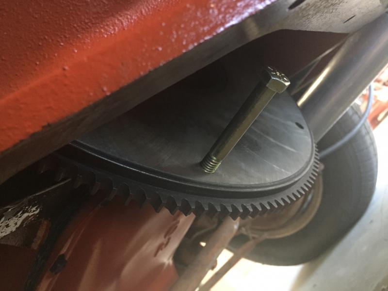

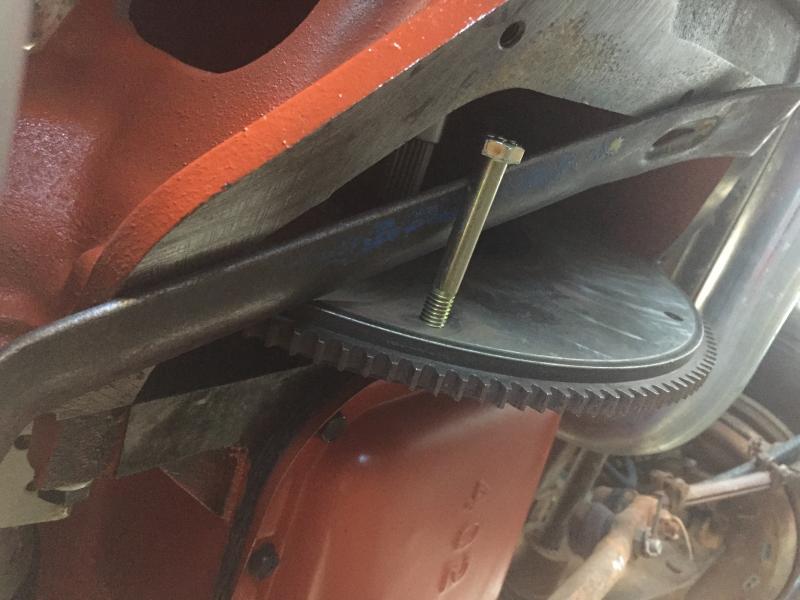

Fly wheel is 3/4 inch thick. Not sure what it is with an automatic. The clutch is not in mine so it made it easy to lay the pry bar across. You might be able to get away with just putting in a longer grade 8 bolt and having it jam against the bell housing.just make sure it's a grade 8 bolt. The others will bend.
Thanks '69bee..it is a bit different with automatic,but this gives me some ideas.

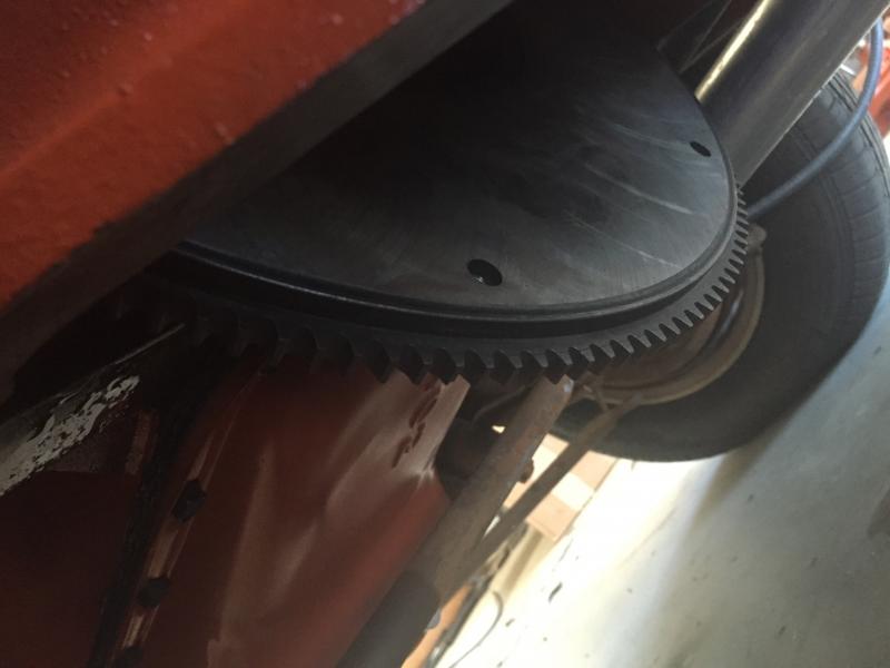

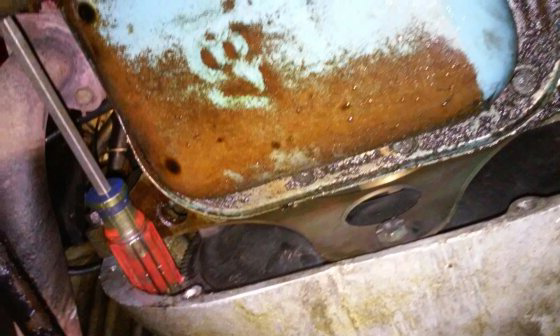

Well...gave that a go. Screw driver kept falling out DESPITE the fact I even hammered it in good and snug between the teeth of the fly wheel and the bell house wall. You can't see it but the other end of the screw driver (phillips head) is resting on the suspension bar. The amount of push I have to put on the breaker bar trying to get the bolt to pop just causes the teeth to dig into the screw driver handle until it starts to move.
THIS ONE stupid thing is delaying everything else,,....half dozen new parts sitting on the bench...two full days JUST trying to break the grip of this bolt...unbelievable.....seems like this always goes easier for others. UGH.

I wouldnt bother renting a cordless impact. That probably wont budge it. I dont know how crafty you are, but you could make a tool to fit in the balancer to hold it so you can break the bolt loose. Like this
