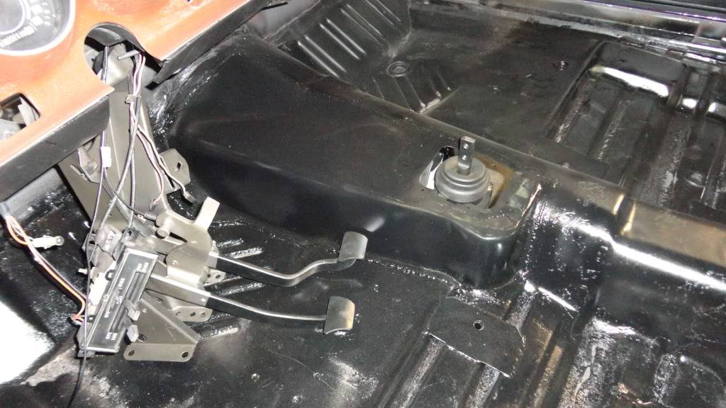

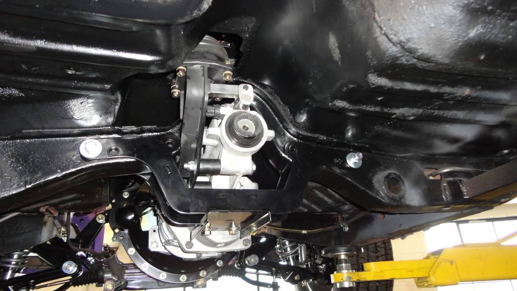

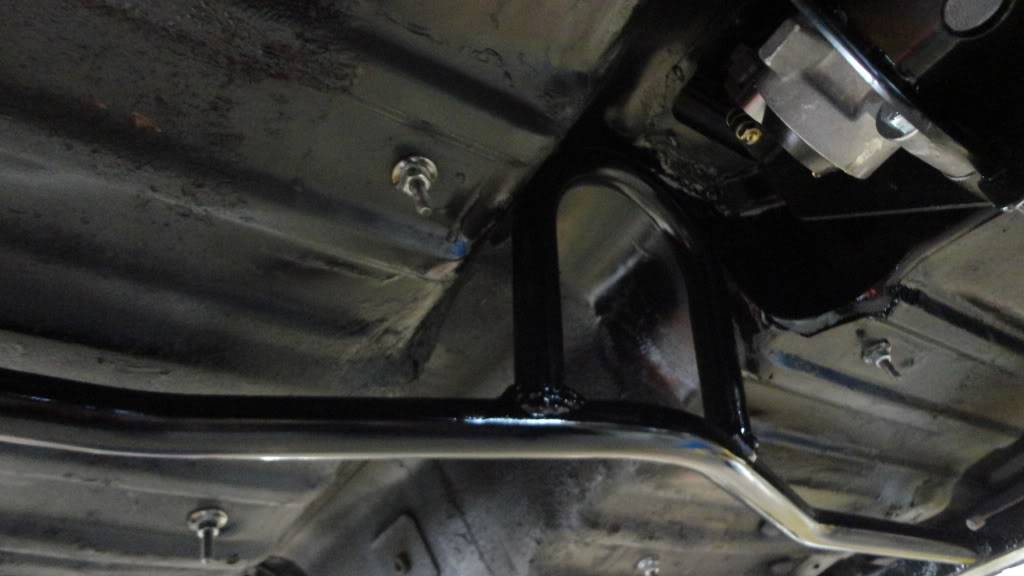

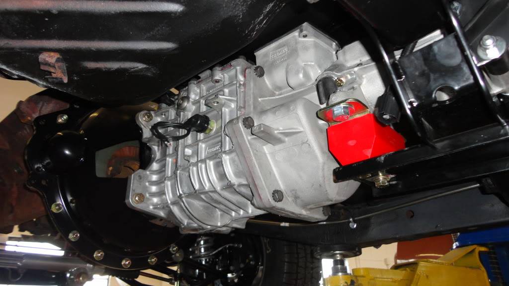

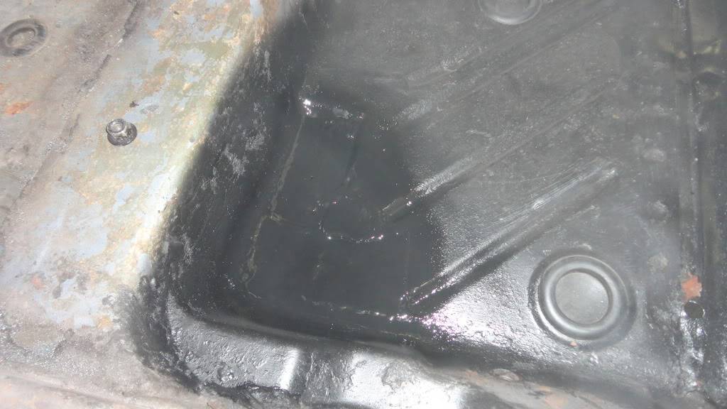

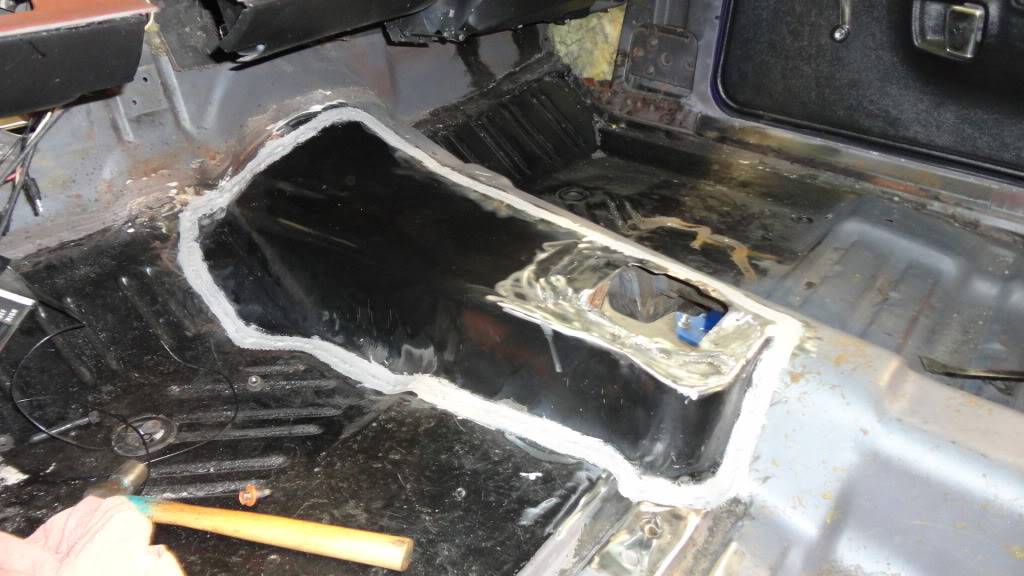

Well the trans tunnel is in, Tranny is test fitted and a few spots on the floor are repaired. New clutch and brake pedal assembly is going in. Things fitting nice. Sounds like I will have it back mid July, then off to the body shop for stripes and a few touch ups. Getting closer.

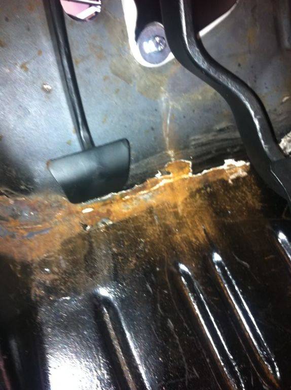

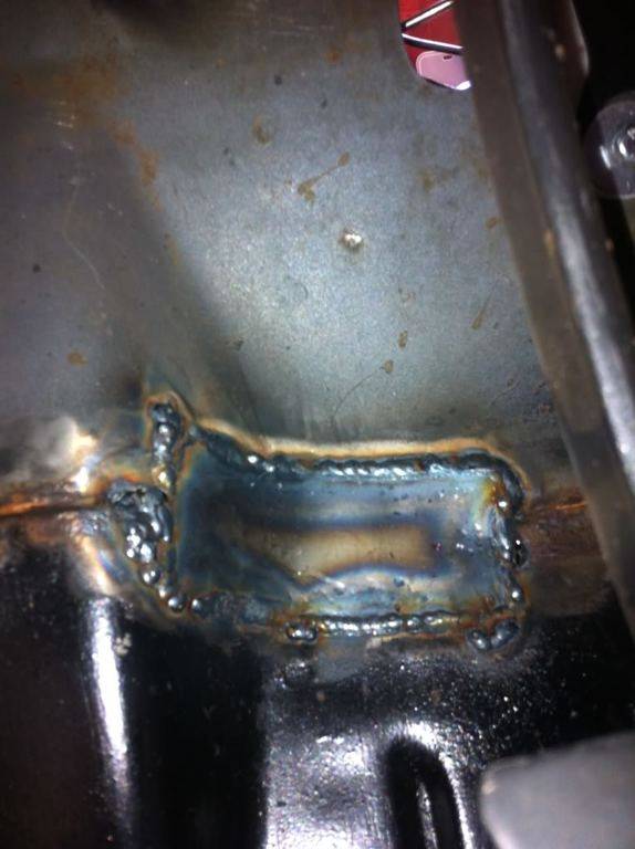

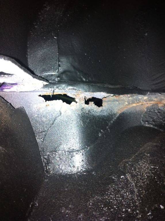

When they were fitting the pedals, they found a couple cancer spots, some fresh metal fixes it right up.

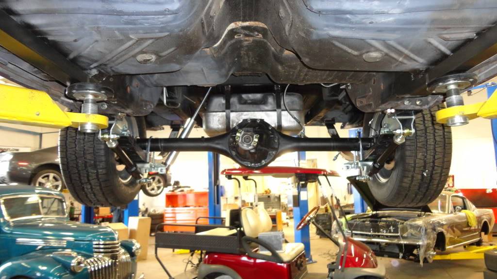

Coming along great! Cant get over just how cool the underneath of this car looks, July may be the finish line but Its better then hurrying, i found that out early... Good luck.... I can imagine the waiting is hard! Good luck to the finish line..

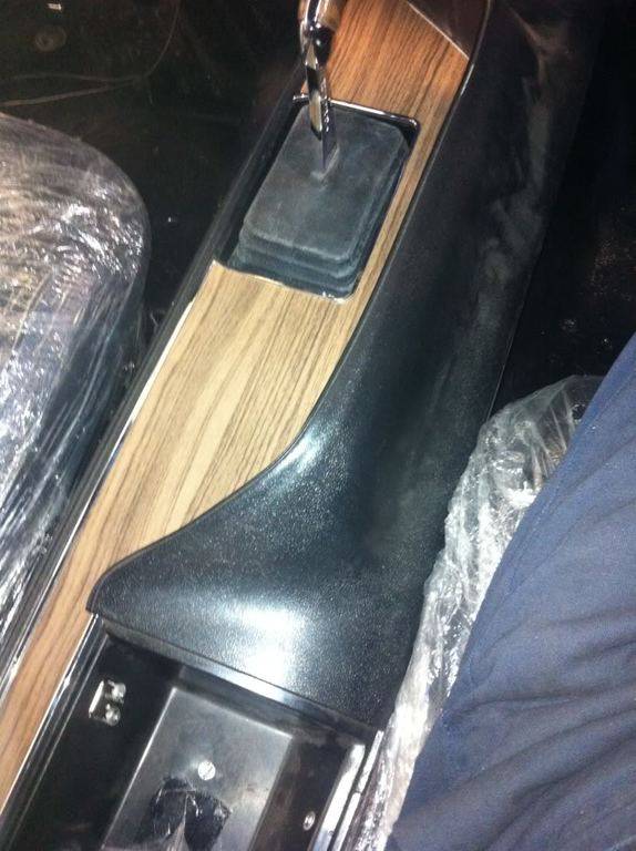

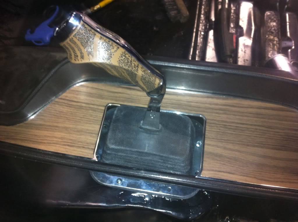

Console and Pistol grip shifter mounted in car and all test fitted. Brackets for the console were modified to fit the positioning of the shifter location. Looks AWESOME!!! Really happy with the results.

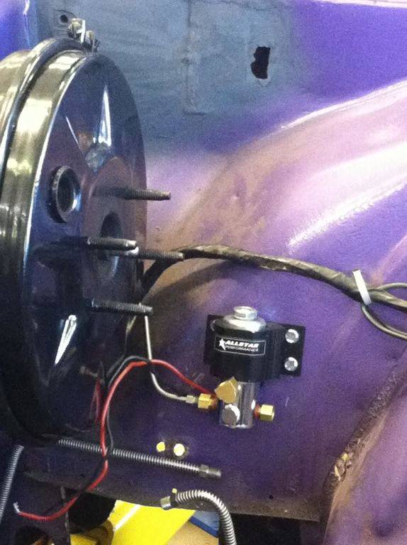

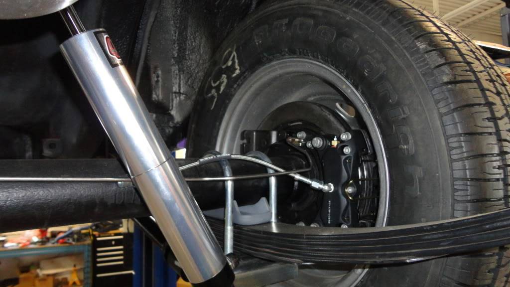

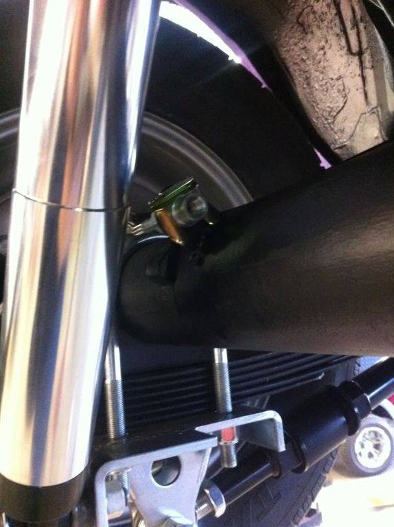

Brake lines being finished up and the line lock going in! :D
Another shot of the console with the seats in.
I like to show my wife the pictures of all you guys and gals who are doing there cars, She loves that shifter.. It does look great in there!! I get things straightened up here some with finances, im going to get one of these for my car, all be it a auto, I like them as well, so what the heck.. May as well make a good looking improvement...

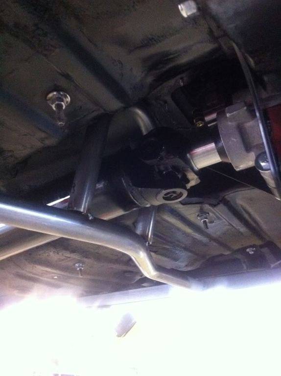

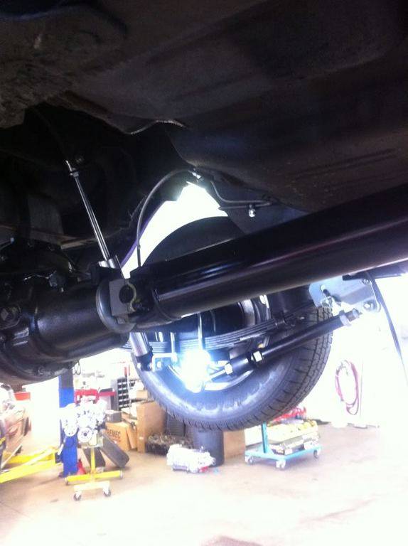

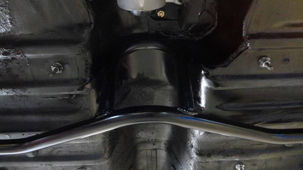

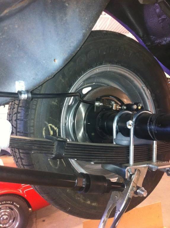

Driveshaft built and hoop welded in. Looking good.

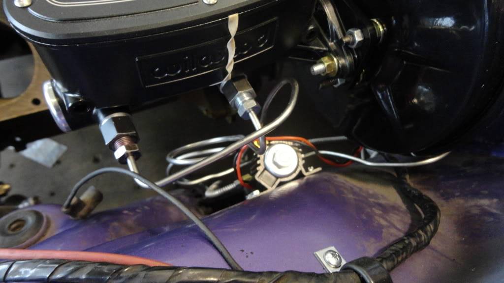

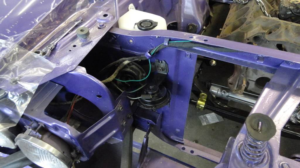

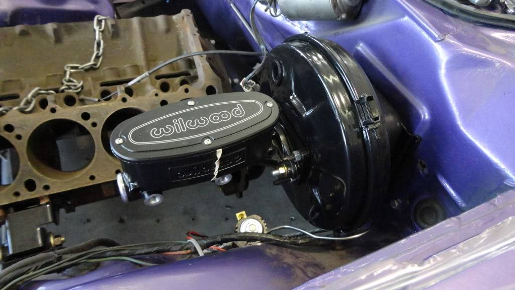

The brakes are almost all plumbed in, booster and master cylinder in place. Horns relocated and washer bottle in. Just need to tie it all together.

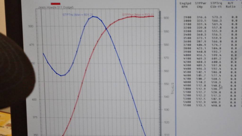

Also the Engine went on the dyno today! Hope to have photos and video in the next day or so. Have yet to hear the results myself.
Engine was on the dyno this morning. My 512 cubes produced 513 HP & 608 Ft/Lbs torque. Not bad for a rookie pass! One pony per cube. Pictures and video to come later today. Getting super excited.
Congrats, You sure have been busy the last 3 days, im getting to expect a new post each day, Thats some HP/TQ to make people take real notice of the Super Bee! Looking forward to a video..

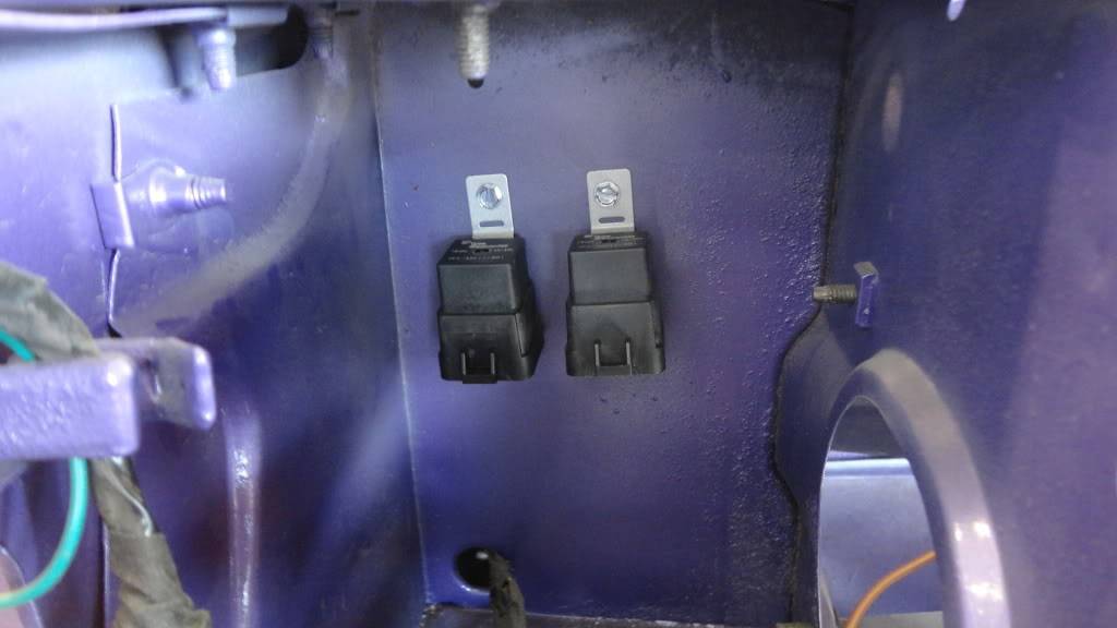

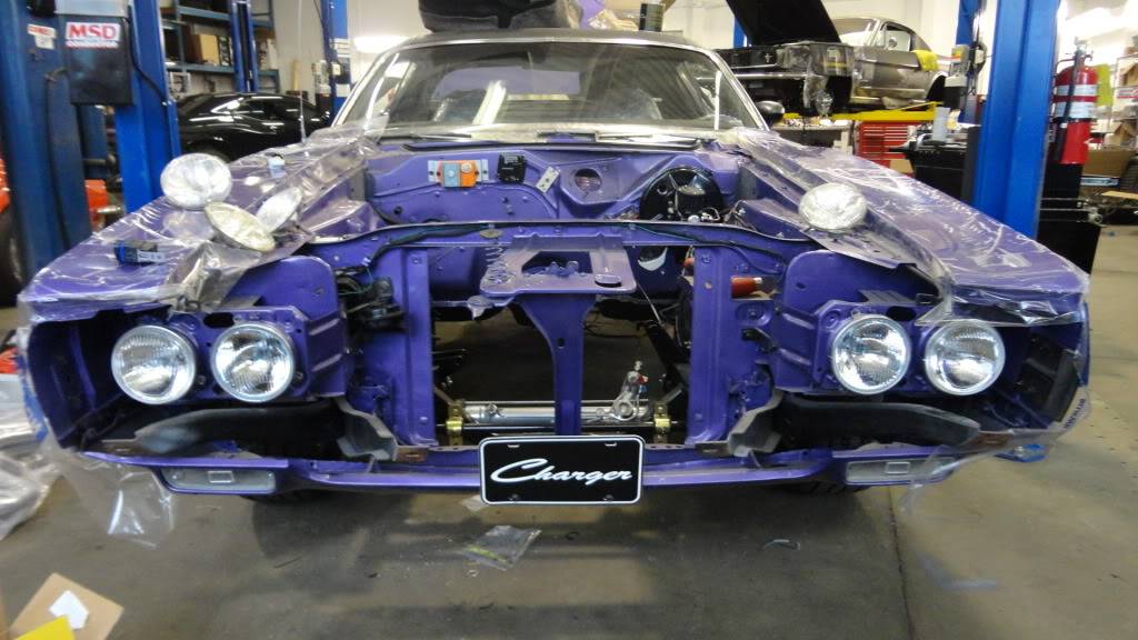

Headlights going in with Relays and Hella lamps with H4 bulbs. Should make evening cruising much nicer!
