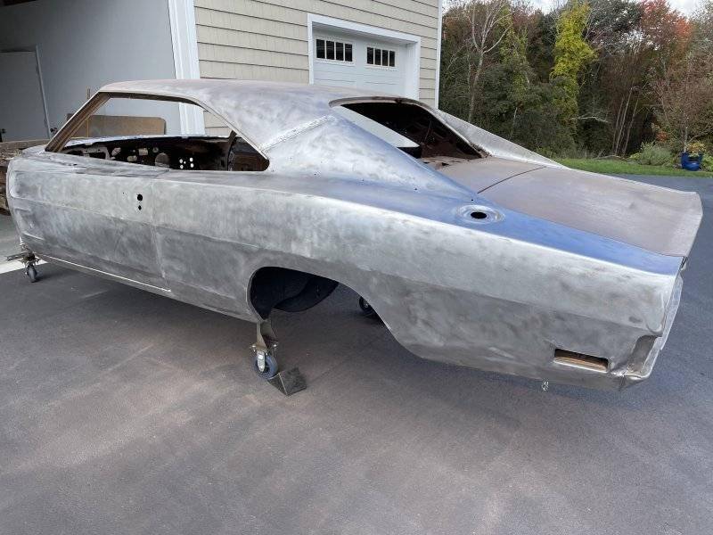

Car is looking fantastic. Looks like your body man is a top notch guy. Great work.
Curious what the advantage to releading those joints are. Just asking because nobody around here does it, probably because nobody around here knows how. They get welded solid and then covered with fiberstrand filler.

I can understand why the factory did it because the lead would harden faster than bondo. I'll be going out to see him next week & I'll ask him why lead today and not fiberstrand bondo.

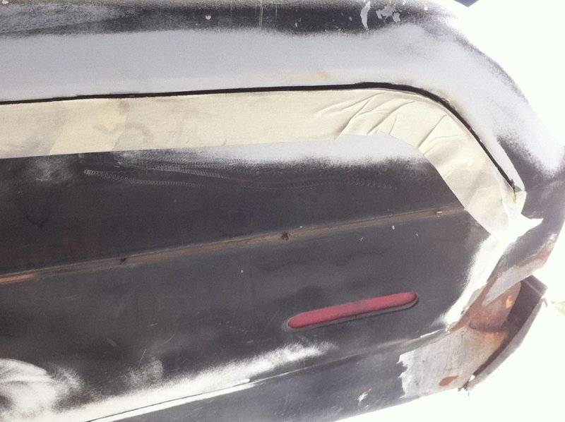

As soon as they got the lead over the peak of the fin,they switched to that rubbery bondo that the factory used.That makes sense why my bronze Charger (built in 12/67) had lead in the quarter-roof seam. This 1970 car, which had a vinyl roof still did have lead in the inner portions of the sail panel and up over the edge for about an inch & a half. You can make it out in this photo....

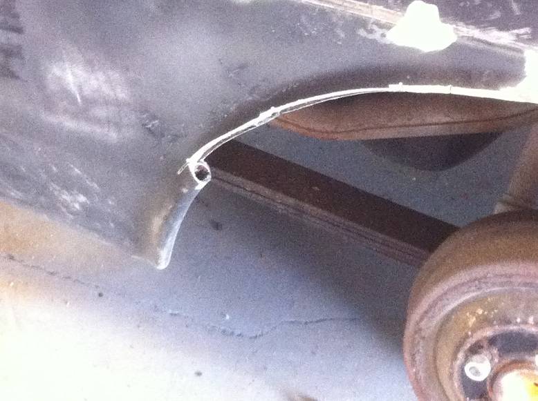

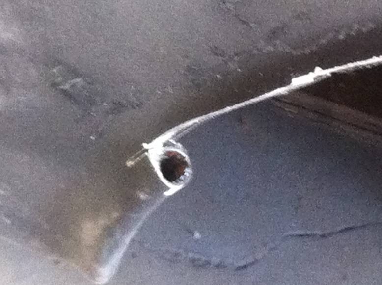

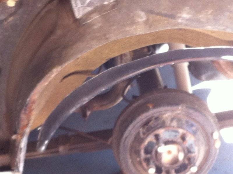

I remember a magazine article in the late 70s (the van era) showing how to use electrical conduit to form wider wheel flares.I'd like to learn about lead work.

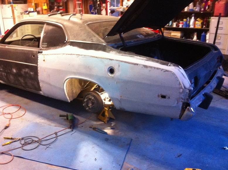

I replaced quarters in a 73 Dart Sport 340 that had some unusual modifications....
View attachment 1615173View attachment 1615174
They used some weird copper tube or something to form a higher arched wheel opening edge...
Weird stuff.
