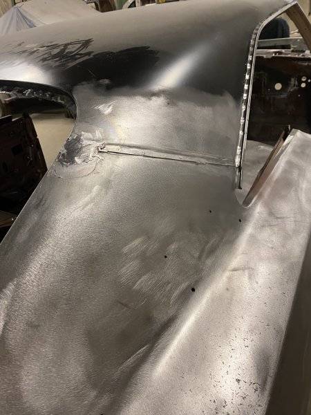

Don't many body guys ?
now use the 'all metal fillers/with aluminum' or other noniron metals
mixed in them for the deeper fills on seams etc.
that are on top & exposed, after they are welded
where the lead, 'used to be the standard'
My stepdad Bob was really good with lead,
hardly any sanding/molding after, a quick file & done
old-school lost talent for sure
I watched Gene Winnfield do some leading on one of his chops
49 Ford, back in the later 90's, it was cool
I don't think I'd want to be inhaling or sanding on that **** (lead) a lot
having lead particles in the air etc.
I know a few plumbers that had issues from lead/soldering copper joint
or packing black iron pipe rope joints
for decades on end, not sure if from the flux or the lead
later they had no-lead solder, harder to solder but less deadly
anyway carry on
