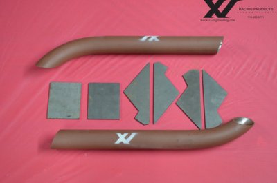

I agree 100%. Rewelded a lot on my car. You probably saw how I braced my shock towers to the roll bars with these XV braces. But if you're not putting in a roll bar to connect them to then you're probably better off with the UScartool type if that's what you're planning.

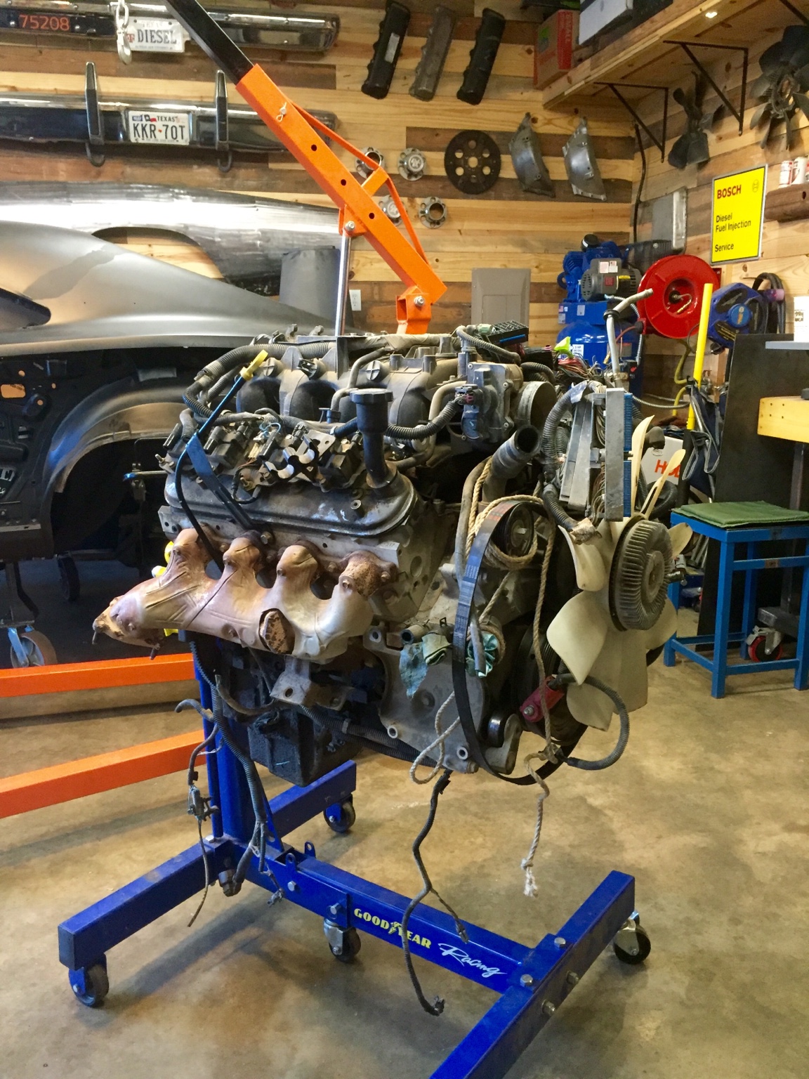

As a birthday present to myself, I've purchased an engine:
From Thanksgiving to now, we've been busy every weekend hunting, hiking, and spending time with family. That time was productive for creative thought, and I'm ready to put those ideas down on steel.
Back to a more regular schedule, projects may resume.
David

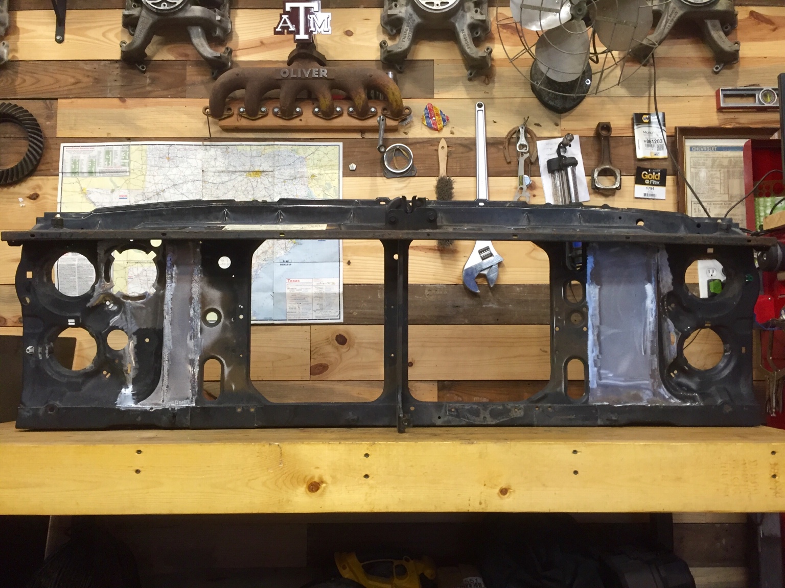

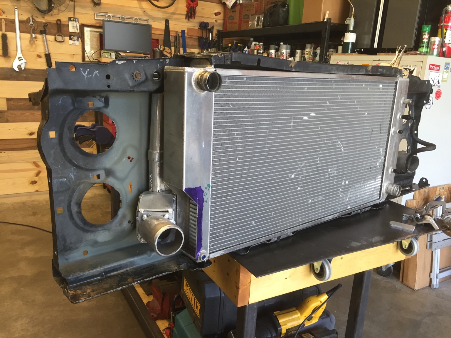

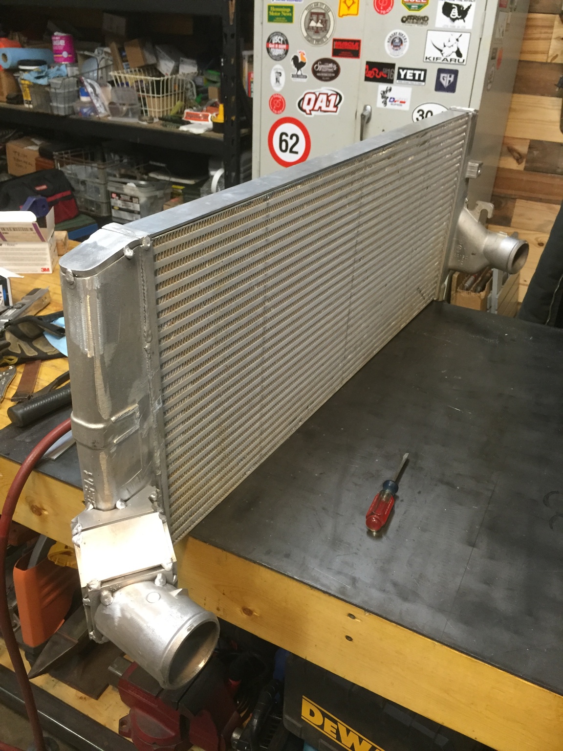

I paused work on the Charger while I adapt an intercooler for my Suburban: modify the core support, modify the intercooler (off a Dmax), and I'll have to modify one tank on my radiator. I'm about to start laying out the oil cooler and AC, and I can start reassembly and plumb the intake tubing.
Lots of practice that will apply directly to the Charger.

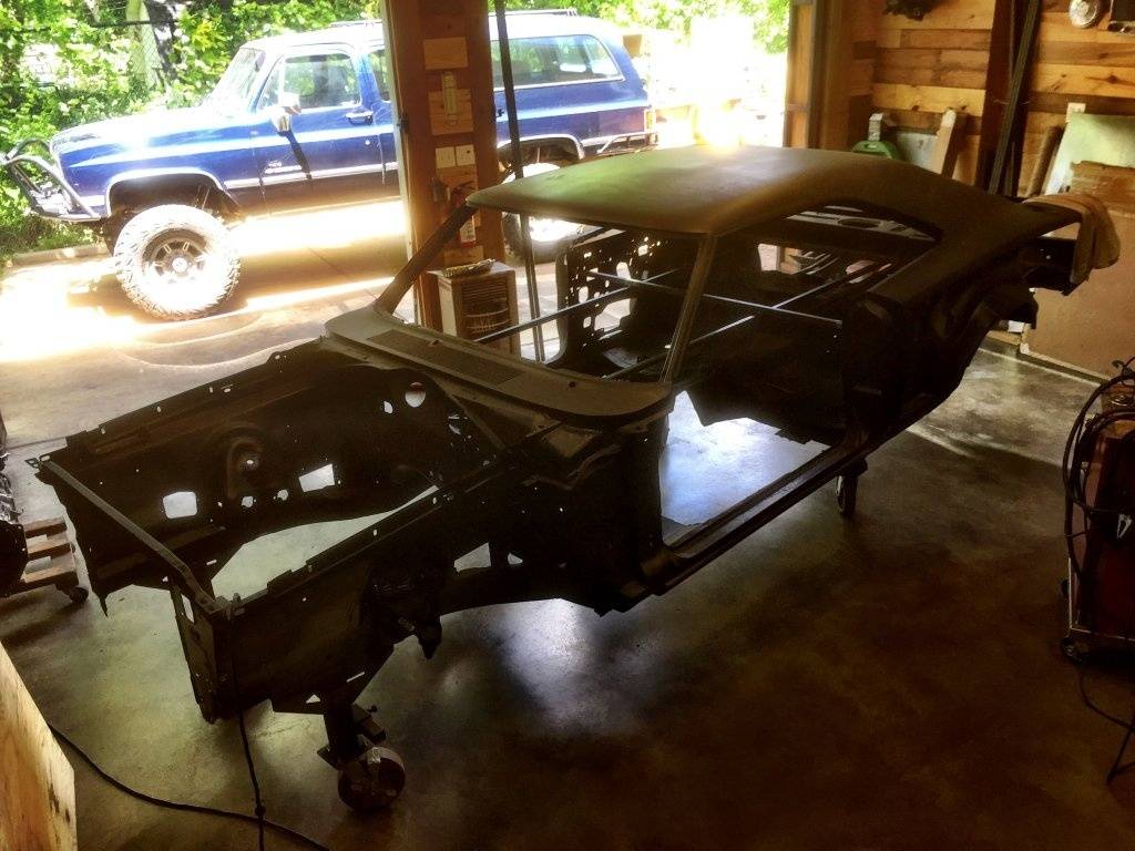

I have a lot of projects, and I'm coming back around to this one.

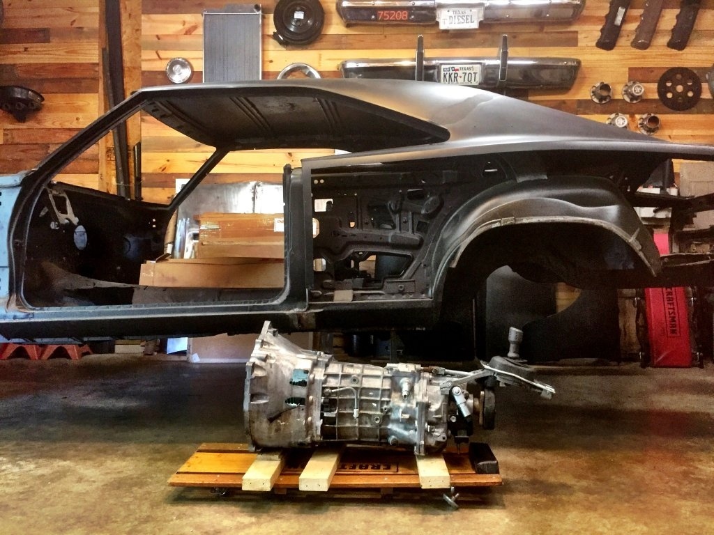

I picked up a TR6060 at a swap meet, and 130' of 1" square tube just arrived. It's time to brace the unibody and get to work building out my chassis.
She's overdue for some attention.
David

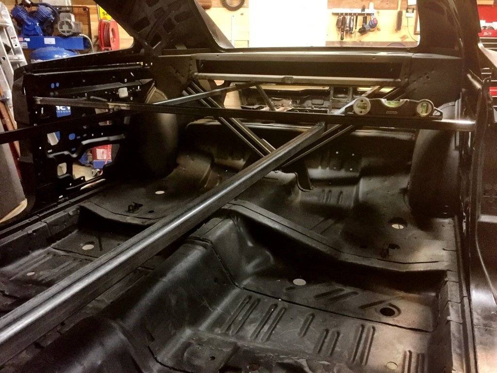

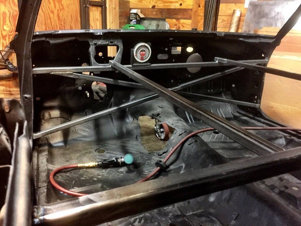

I spent today cleaning up the shop and reorienting the space to work on the car. With the floor about to come out, and pretty extensive chassis stiffening plans, I went ahead and loaded in some more general reinforcement for the unibody.
I missed working on this car.
David

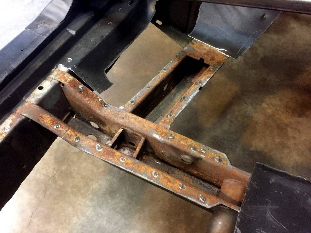

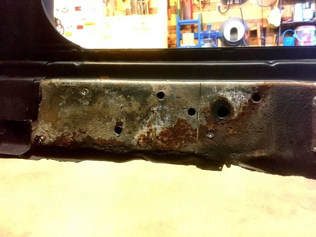

With the front floor cut as far as I can with the plasma, it's down the the tried and true mechanical method of removal - broach cutter, gentle pry bar, and the air saw.
The rails and crossmember are in solid shape, and it's all surface corrosion so far.
The rocker box looks like it took a hit at some point, but it only deformed the pinch.
This kind of progress is all about hours, and I'm getting them in where I can.
David

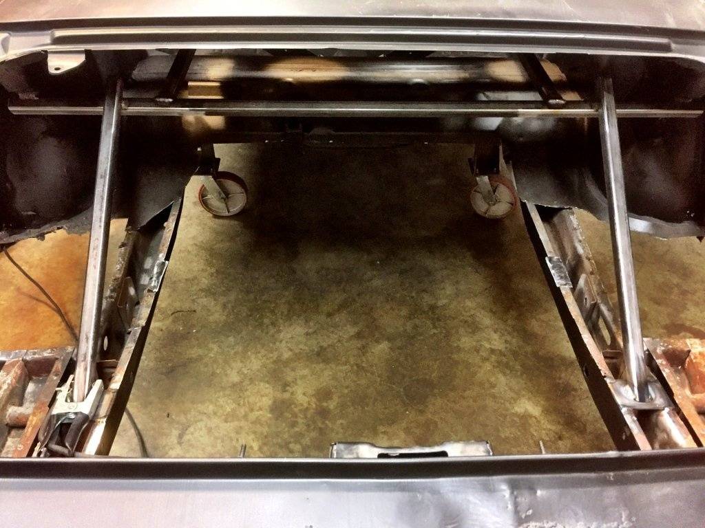

Rest of the front floor is out. Spent some time pondering how to tie the rear frame to the temporary bracing so I can plate the inner rocker.
img_0044-jpg.229452
I have a plan, but I need to sleep on it.
img_0046-jpg.229453
