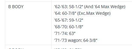

Here is what I am doing to my dads 62 polara. I bought 15x8.5 rear rims w/ 3.81 BS w/ 275/60/15 nitto drag radials. I put them on & they rubbed the quarter lip ALOT. Come to find out the rear in the car was out of an 65-67 Bbody. They are 1 inch wider than the 62-63s. So I have coming an DANA rear that is 571/4 wide. In which is 1 1/4 narrower than the factory width for that year. I am getting the rear cheep so I am hoping it fits.

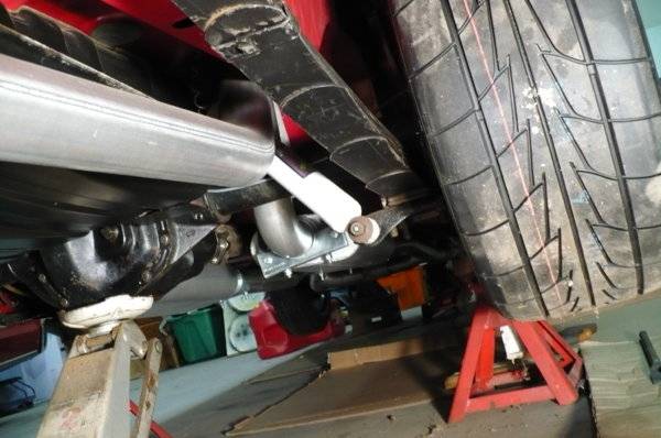

You have to do the math useing a straight edge against the drum. I thought I had plenty of room between the wheel and leaf spring but I didn't really think the tire stuck out past the rim as much as it did once mounted. Well it did so I needed a spacer. Live and learn. The 275/60 can have just enough clearance, in and out, if you get it centered just right.

That's what my dad put in his 62 ( 67 B body 8 3/4 ) but it was to wide. The 65-67 rears are 1 inch wider than the 62-63 rears. That size tire rubbed the quarter lip. Alot

The Mickey Thompson Pro bracket radial 275/60X15 (larger than a normal 275) on 10" rim will fit if you move the stock hangers flush to the rail.

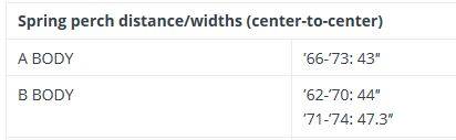

62-70 B-bodies are all the same length. Spring perch is 44". So, my statement was wrong on that. Just wanted to keep my facts right.
I pulled this off internet search, not a guarantee there're right. Lower B-body is width drum to drum.
Yes the spring perch width is all the same. The drum to drum width is not. I learned that the hard way.

I flat wasn't sure. But, if that 8 3/4" rear is for a B-body, no reason it won't work. Even if, as mentioned, you use offset hangers and shackles, and move the springs in. Bunch of work. The clearance issues I had was on the outside because the 65-67 rears are 1 inch wider. Not all Bbody rears are the same width. Not all B body rears are the same width. The clearance issues I had was on the outside.
