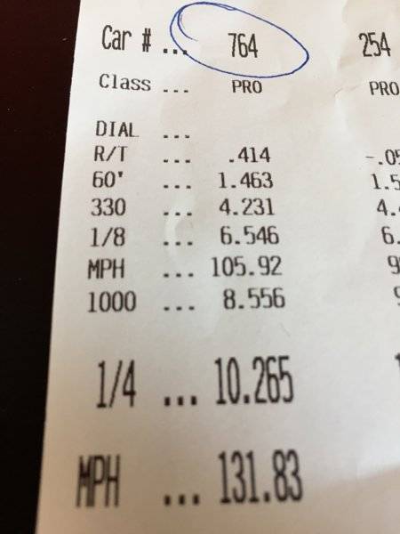

Have 3 passes in. Driver needs work! 4500’ air.
10.265. Et
131.83 mph
6.546 1/8
105.92 mph.

That ET, mph and 60' are GREAT with crappy 4500 adj altitude... That is real close to 10 flat in 1500 to 1800 feet of air (if you ever get that at your track...i don't know about that)
PS: your 1.46 60' is especially great. At my 10.15 to 10.17 ET's my best 60' is 1.50 and typical is 1.51. Your suspension and tires are working...tell us again about your complete suspension system, front and rear and tires, etc plus what rpm are you leaving at off the transbrake (presuming you have transbrake ?).

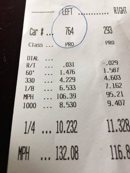

First pass today. Spinning. I changed shock settings. Went wrong way but still moving forwards.
Great runs and I was just funin ya. I like .020 lights and every now and then .010 light thrown in. I will be headed out next weekend.
Bob :moparsmiley:[/QUOTE
Getting better on the light but a tad slower.
I'll take a .023 forever. You'll win way more than you lose.
