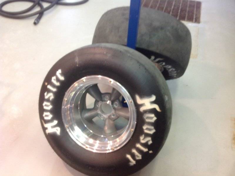

—-Malex, while perusing eBay last night I found a pair of 12 inch Super Tricks, actually a full set including fronts. I don't remember the back spacing but it might be worthwhile checking them out. The listing stated, he would separate the set. I think the price was $300.

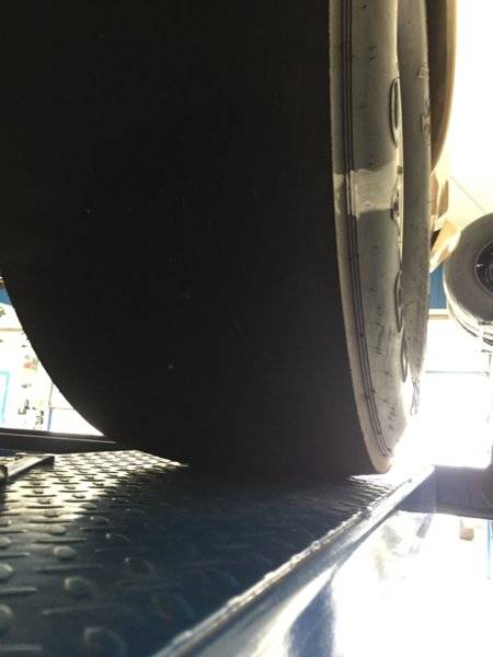

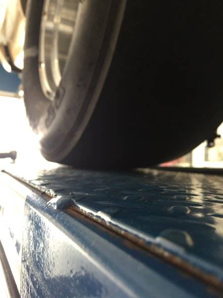

would sliders be better for the street also or is that to much. seeing how i want double duty. just a thought
---Your going to beat my personal best on July 14th. My bet is you will get the finger wag for dipping into the 9’s
This 3 week break before next race is too long. On a positive note Barney will have a new set of D60 gears to punish.![]()

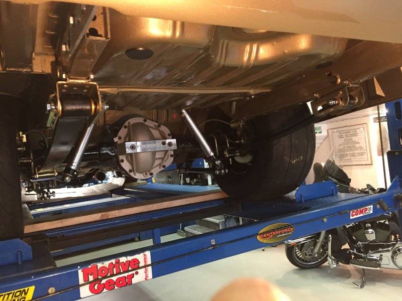

---Malex, what brand of sliders are those and where did you find them? Looking good! Can't wait for the next update.
---malex, now with the sliders are in are the rear shocks loaded hard or soften up. also the pinion angle stays were it should because the body is lifting and the rear end is planting the tires. the cal tracs job is to hold the load from weight transfer and to help keep it straight.
