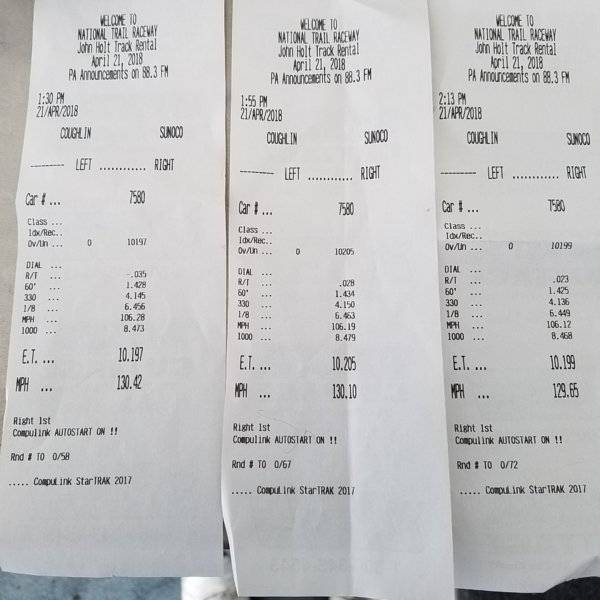

We have about the same combo, gears and converter. 4.30 and 5500 stall. Calverts and sliders, 64 Plymouth. My front end is super loose easy to lift up, calvert non adjustable. Shocks. Here are 3 time slips from the spring, 50lbs of ballast in trunk, foot brake.
I'm assuming your 18R was at full stiff. Time for a revalve or another pair.

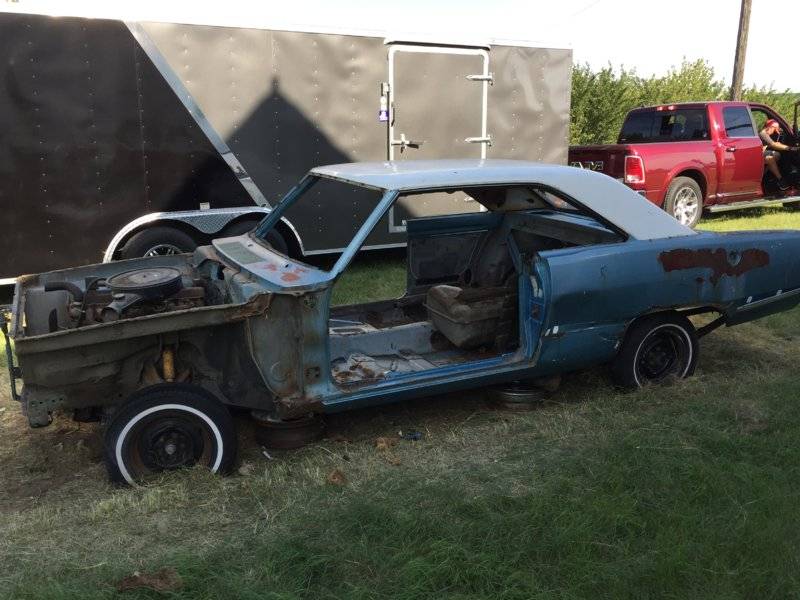

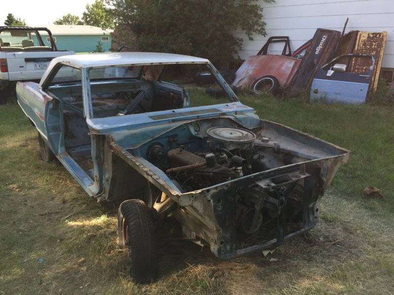

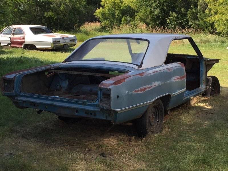

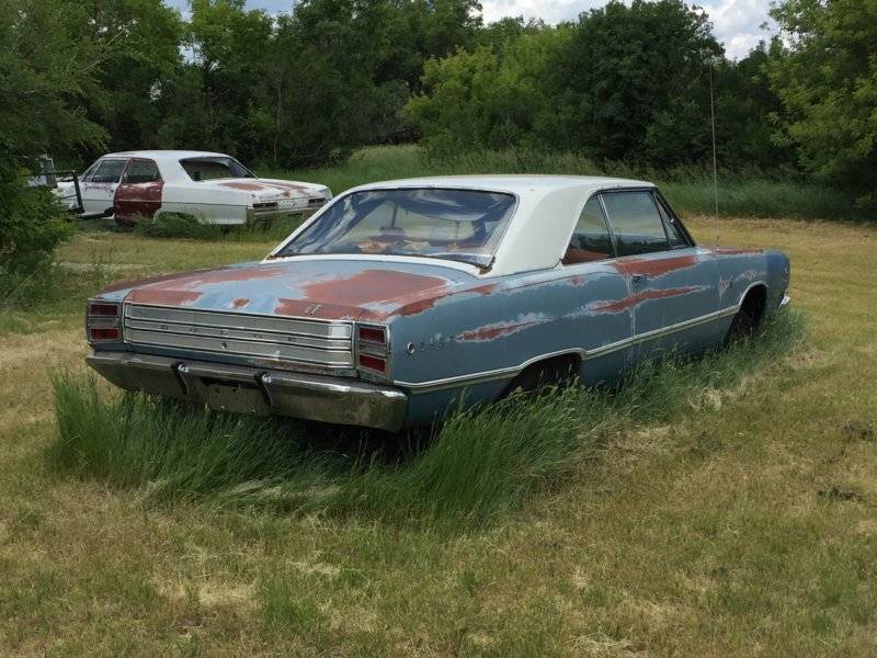

This one has been sitting for many many years. I believe that it originally came off the road due to an accident on the left side. There's damage on the left fender, door and quarter, and it came with a spare left fender and door, both mint.
Without a title the only way to get across the border was as parts. So that's the way it comes home. Crossing over yesterday they didn't even ask to look in the trailer, told them old car parts and showed the bill.
I did find a parking receipt inside from Seattle, had to be in there for decades.
The Dart needs floor patch panels on both sides in the front and a left side quarter skin. Rust is minimal throughout, it was a good find but will take back seat to the 64. It's a winter thing.
