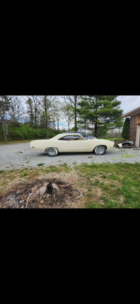

I'm planning on painting the car this weekend. I have 2 gals sprayable basecoat and 2.5 gals sprayable clear.
Base is cromax and clear is chromaclear 7900s. Is this do do the outside os a 70 satellite? All jams are done. It's a pepper gray color. Should I mix the base and reducer in one container or mix as I go? Any recommendations would be greatly appreciated. This will be a first overall for me.

Did you sand it to bare metal, do the body work and epoxy primer? You should be able to cover it with 2 gallons, if everything goes well.
You may be underestimating the amount of time necessary. Is the car stripped down, or does it have all the windows etc still in it? Are you painting the engine compartment, trunk, floor? You can spend several hours just taping off, wiping down and all that. Cleaning the paint gun can take some time to make sure it sprays right. I had my car at the painters for 2 or 3 weeks, that is after I did all the major , stripping , sanding, taping and body work myself.
It's a rolling shell in primer. The jams have been done since this pic. I'm sure it will still take more time to do than I think.
It's been in primer for quite a while. It sits in the garage if that matters. Blocked yes. Sealed no
Ok, thanks. Sounds like I have a lot more work left than I thought.....
