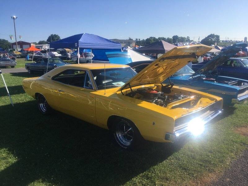

I run 235/60/15 on a 15x7 front and 275/60/15 on a 15x8 in the rear. Just like Hunt2elk said, that seems to be a pretty good combo but the 15x6 will work on the front for sure. I would run a 215/70 ish size on front if going with the 15x6 rim. If you decide to step up to a 15x7 front, then go with a 225/70 or a 235/60 for a squattier look.
Thanks, guys. I think I’ll go with the 15x7 in the front as suggested. Charger looks great! This helped tremendously and can’t wait to get the new shoes!
