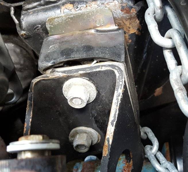

Fyi, if you have poly mounts, inspect them.
Poly mounts suck, they have an inherent design flaw.
Imagine them without the poly, the two metal sides of the mount do not touch, but you could slide them apart. The idea, I think, is they will stretch to a point, and stop.
The problem is the direction of the slide is up/down, and as you know when torque is applied, the left side of the engine wants to twist up, and the right wants to twist down.

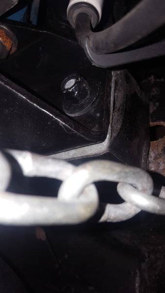

I've gone through 3 sets of poly mounts, all warrantied by Schumacher. After the first time, they asked me to make heat shields, which I did. In my case it shouldn't matter because the left mount is in the front, far from the header.
I also have Schumacher headers, and they wouldn't warranty the mounts unless I did. I also have a chain, 2 actually, as there is no torque strap for a BB a-body.
With a tr and a hole in the hood it was obvious when the right mount failed because when opening the hood it would make contact with the carbs on the right side. Engine shows no sign of movement when revving it with the hood open, or when driving it.
The reality is both mounts failed no matter what.
A friend told me he had the same mounts and had no issues. I noted his motor isn't through the hood, so it wouldn't be obvious. A close inspection showed the same as mine.
2 different mounts pictured, both are the left side.

Matthon; were those pics of Schumacher poly mounts?
Yes. Both had 'slid' and caused the engine to tilt towards the passenger side.
There was no visible movement of the engine when driving it, they were still together, but had moved and would not move back.
I actually cut one apart to see what's up, and it was a pain to do so.
Just poor design.

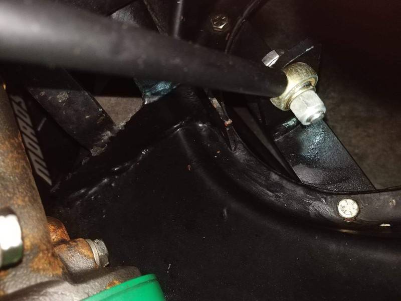

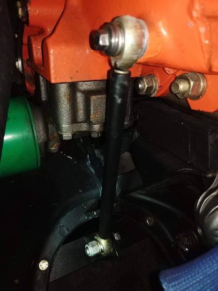

I was reading here about Schumacher closing up recently and a number of people wondering where they could get a torque strap. Might l suggest they make their own. I made mine out of a piece of thick wall tubing, threaded it the size of the Heim joint of your choice. I welded a mounting tab onto a piece of flat stock and drilled a few holes and "Bob's Your Uncle" l bought a mig welder shortly after buying my car and getting some quotes for body work. Let me tell you, that welder has paid for itself many times over.
Look up S&W Race cars, I've bought many parts from them including kits with tubing you can cut to length, weld in threaded ends , Hiem joints and spacers, etc. you can get everything you would want or need to build a variety of supports or brackets to fit anywhere - I built a few for my cars and they are pro race pieces so they look great ! I run a mid plate and needed support front to back as well and they have anything you could need or they can make it if you're not up for it.
Go to S&W , you can get a kit w/tubing, threaded inserts and heim joints, weld or bolt tabs on K wherever is good, if you don't weld you can take tubing to a friend once you measure & cut length you need, have him install threaded inserts and bolt it on - you'll have adjustment like your tie rod ends / I made several / but since I put front & mid plates this time around I didn't need them - you don't need Schumacher for that part, it's only a straight rod ( no rocket science involved ) even if your car is a rocket ? - LOL
