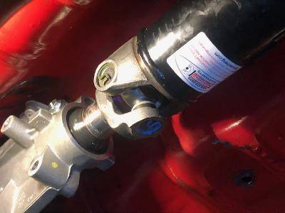

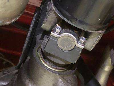

The drive shaft came in today.
How much for the driveshaft?

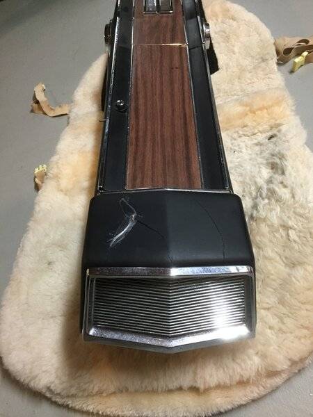

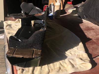

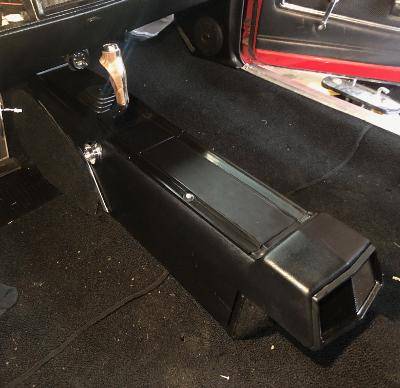

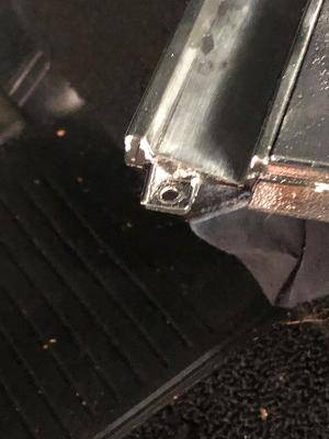

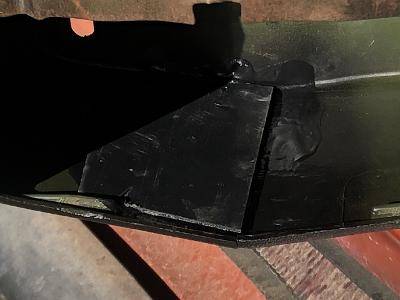

The underside of the back end of the console. I took ABS glue and smeared it on the console, then stuck a piece of 1/8" thick plastic sheeting to add some stiffness.
I have another console that is cracked in the same spot!

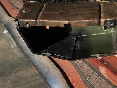

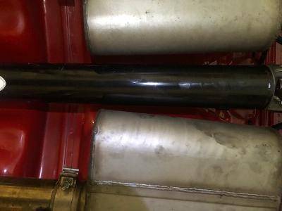

Perhaps check it through full suspension travel. Mine will sometimes touch my x-pipe at the fully unloaded position, but doesn't anywhere else. Maybe there is a spot in your suspension travel where they might touch?The other drive shaft sometimes made contact with the edge of one of the mufflers. Because of this, I was curious if this larger diameter "propeller shaft" would be worse.
It clears by more than enough. Awhile back I had the RH tailpipe out to make a few clearance dents. Maybe I somehow accidently made some room?

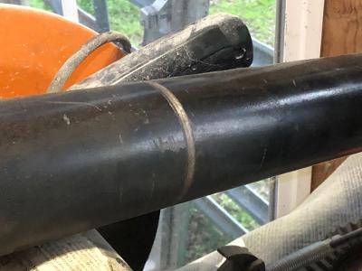

Old drive shaft:
