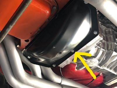

The dent in the oil pan gave me the excuse to pull the pan to repair. Thankfully,  it helped me to discover the improper fitment of the plastic windage tray to the "shorter than stock" Milodon pan. $270 could have been saved if the pan sealed and wasn't dented.
