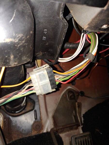

Update :::: I know it's been awhile on this post but messing around in the garage and wiggled the coupler in the picture and everything started working will dig into it when it's a little warmer but thought this could help someone with similar issue
