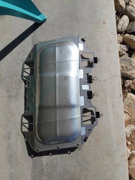

Personally, I run a thin paper gasket on each side of the bathtub.
I glue them to the tin, and lightly grease them at the head & intake.

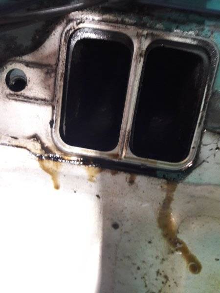

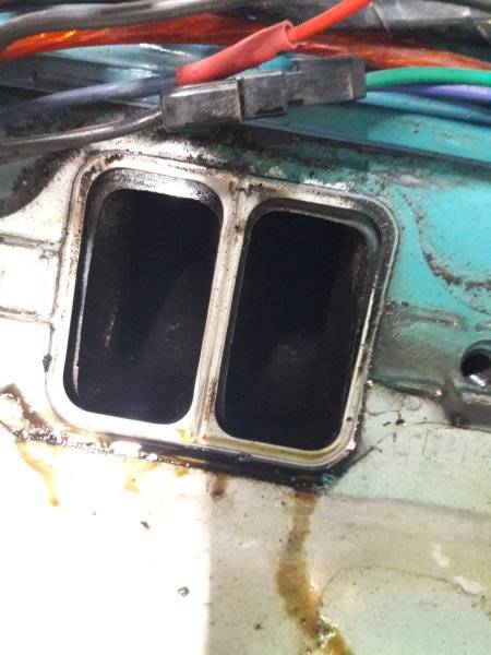

I was fouling plugs on the passenger side bank. Car started running poorly. Talking over my troubleshooting with @gtx6970 he asked if I had a paper gasket on the intake. Didn't know one way or the other as the motor was built 13 years ago by previous owners. When I pulled the intake oil actually puked out the number 2 runner. No paper gaskets in place. I decided to follow the Edlebrock instructions and got the Felpro 1214 kit. Glue the paper gaskets with gasket shellac.
