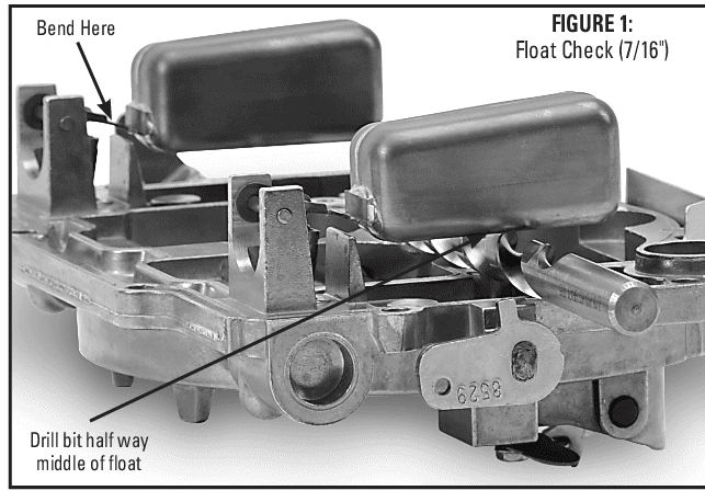

This is my first one of these carbs and if the floats aren’t right out of the box then it’s likely running out of gas. I assume when they’re low?
EXCELLENT GRAPHICS....one additional item to CHECK....MAKE SURE the float's pull clip is installed. Thus is an often overlooked part. It attaches to the needle valve stem AND the float's arm near the pivot pin's "ears". The purpose is to insure the needle valve starts to open as soon as the float starts to drop. This little item helps to maintain a constant fuel level and accurate metering.I'm not exactly sure what the point gap is mainly because I don't use feeler guages. I'll eyeball the gap, hook up the dwell meter, hook up a remote button to the starter relay and crank the engine. This is with the dizzy cap off. Then open or close the points to get the dwell you want. It's much easier than using a feeler gauge and the most accurate.
Yes, if the float level is too low the carb can starve at WOT. I believe the setting is 9/16". I'll try to find the diagram where to measure to.
It's 7/16". Using a drill bit works the best.

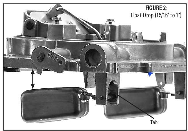

Like Bob R mentioned, check float drop also. 15/16" to 1"
