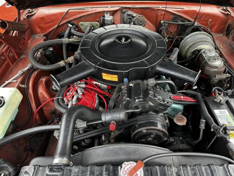

Hi everyone,
I have a fully restored car, stock 383, starts every time, stock air filter. I go cruising every weekend, driving around town etc. I don't usually floor it, normally driving under 3-3.5k rpm.
This weekend however, my buddy got himeself an R33 GTR, so we decided to have some fun on some straights. When I floor it and keep it to the floor, I hear this horrible vavle knock, which is never present when driving normally/medium load. What is going on? Engine has 6k miles after rebuild.

Right, need more info. If you aren't hearing 'rattle' or pinging at part throttle and the valve train is quiet, you are probably experiencing engine ping....too much timing can be one culprit. Does it make the same noise when the engine is cold? Take it out and try it. If it's quiet or not as loud, it's probably pinging. Your spark plugs will most likely should signs of it happening. You do NOT want to keep on driving it hard if that's what's going on. If the temp of the engine goes above 180, that can also contribute to it. If the car runs good and you don't want to bump the timing down, try some octane boost. I used to add some av gas to my stuff to help it quit pinging....
Its a loud metallic clanking sound (ratteling) very clearly heard in the cabin... could be spark knock. Otherwise, no smoke, runs smooth as butter otherwise, on warm engine starts right away.
I run regular gas, i tried running higher octane, but then get blue smoke out of the exhaust (on idle and otherwise). Car runs normal temp, around 180 even on a hot summer day (i live in Miami and have a secondary temp gauge under the dash). I don't know what the compression is, I didn't do the restoration, but when i got the car, it was pretty much stock (even stock headers), so i assume stock compression.
So I should change the sparks, and do timing adjustments? I can do the sparks myself (any recommendations for plugs? what should be the gap?), but should i have some pro shop do timing? I've never done timing adjustment. Are there any specific specs for timing?

I noticed you have an aftermarket MSD Distributor and Coil.
I agree you should start by adjusting timing and running high 93 octane fuel.
Looking at his motor he has MSD with no vacuum advance. He needs to check his total timing. My bets he has heavy springs and the total is well over 36 degrees. Heavy springs will cause more advance to pull in at higher RPM's. Either get the dizzy tuned or run higher octane. Premium fuel is not going to make it smoke blue.
Premium fuel when your car was new, was at least 98 octane. If you're running 87 octane regular fuel then this is your problem. If you retard the timing enough for it to not ping, you can throw performance out the window.
What is your total timing? Try knocking it down a couple degrees and trying that. Also, if you have light springs in the distributor, it may be coming in to fast.
Lighter springs it would rattle at lower rpm's. He says 3,500 and under he does not notice it. Heavier springs is keeping the timing lower for most conditions but allowing more advance over 3,500 rpm's. A 5 minute timing check would verify this.
I suggest he trys again with 93 octane before touching the timing/distributor. :)

I think it’s detonation (pinging) from his posts but those dual air conditioning belts can sometimes raise a racket if not properly tensioned and all alternator and air compressor bracing in place. I had owned my 67 GTX with AC for nearly 20 years before I realized I was missing a lower alternator brace to the engine. Revs much quieter now. It has a bone stock 68 440 in it and anything over 34 degrees combined timing runs the risk of pinging on 93 octane.
So shouldnt be getting blue smoke on 93? I thought these were supposed to run on regular ‍♂️
If blue smoke was a glitch that one time, im think i should try 93, and maybe change the plugs…? What plugs/gaps yall recommend?
