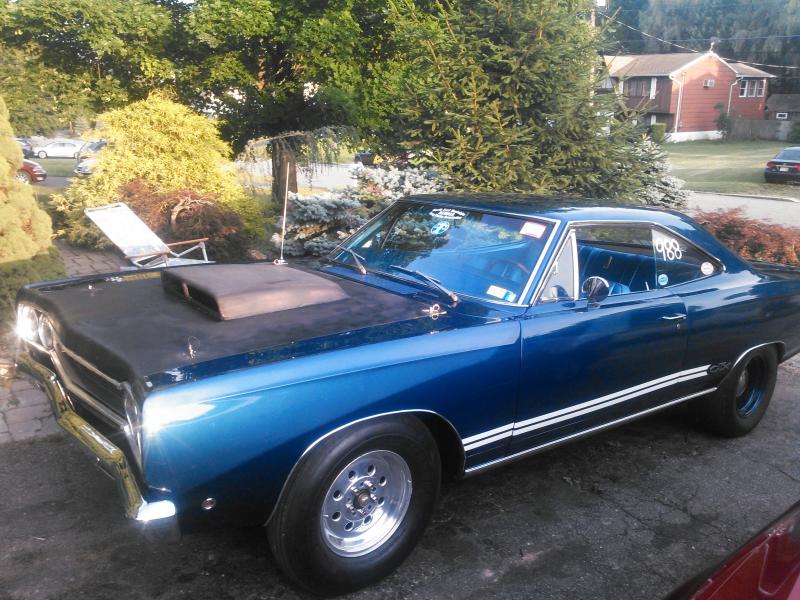

Waking up the beast
Hopefully it will look great when it gets finished,
it's a little gaudy yellow right now...LOL...
A little "organsol or semi gloss black" when you get finished will all the prep & fill work
{hopefully you don't add back "too much weight" to the 6bbl scoop/hoods final product...he he ha ha}
are you going to make it functional ram air too ??
good luck, have fun, every little bit helps...

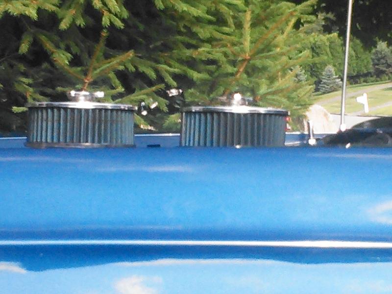

Down the road I will make it functional.I just want to get it on the car for now. I cut out a bunch of plywood that was is the hood to start. So
I'm lighter now with the scoop than I was with a hole in the hood.

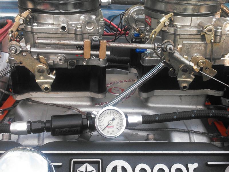

Had a friend who had an edelbrock 4 hole 2", so I just bought one more of those. My throttle cable needed a little tweeking but it works. it raised my idle about 200 rpm.
