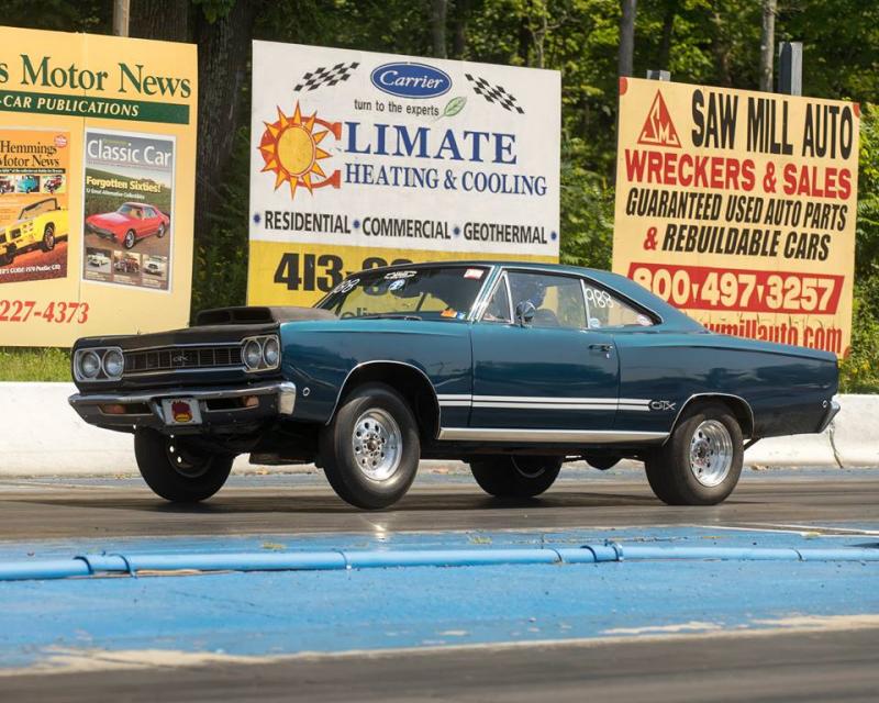

Picture from Saturday at LVD
Car looks great, much more balanced too with those frame connectors. One speed secret I heard years ago from an old MOPAR guy... paint those new wheels black - shiny stuff slows a MOPAR down by at least 1/10th.
