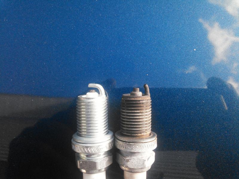

Changed my plugs today. here is #5

After jetting up and changin to a colder plug, my plugs are still reading lean. I really need to get a wideband for the car. I really hate stabbing at it especially with the dual quads.

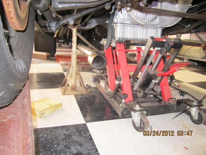

I'm getting too old to pull trannys on my back.Can you find a lift to use?? Or get the kid to pull it

I'm with Hemi-It is,
I hate being on my back, on the ground anymore,
let alone in the rain outside in the driveway...
that's a nice tranny jack Al !!
Good luck Bobtile
The trans will not fit under the car while on the jack.Have to slide the trans under and then lift onto the jack.
