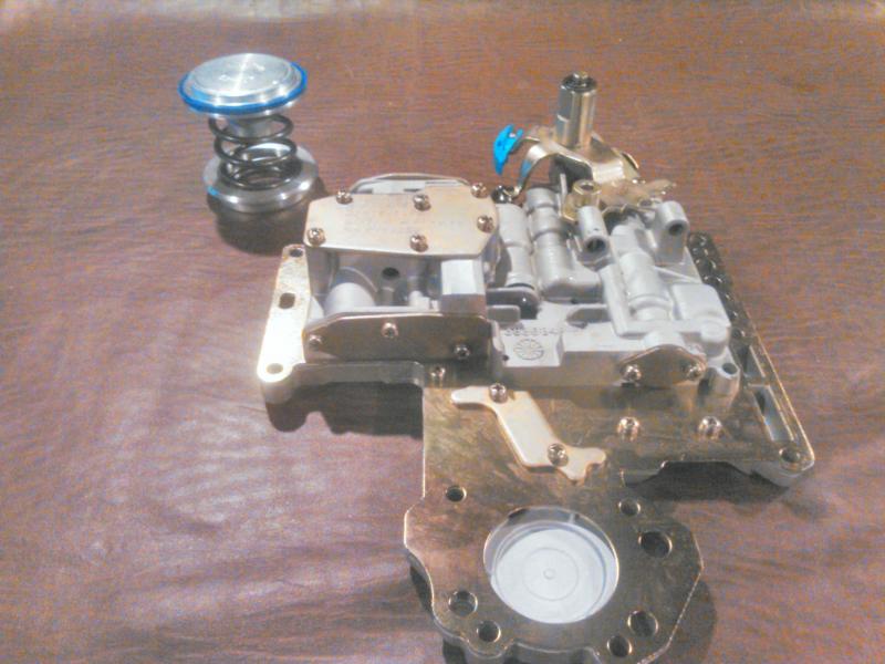

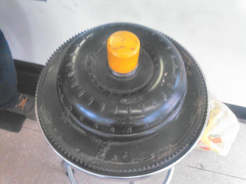

Let's try this again.
Man can't wait for some results! That looks like a 8"............ What valve body?
Yup, it's an 8". I have a 9.5 being made but isn't here yet. Valve body is an A&A reverse pattern manual w/low band apply
