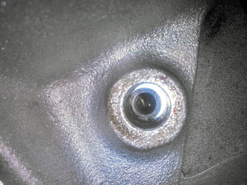

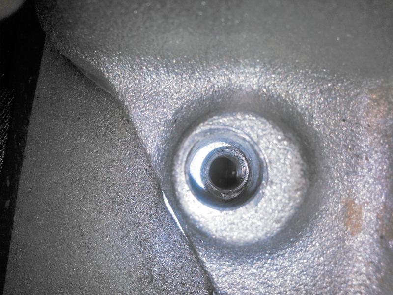

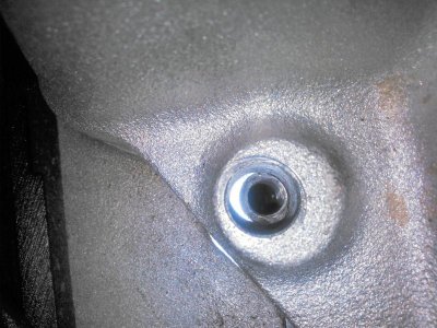

Have Amish Bob post a picture of bolt holes...
Here's what the holes look like with no gaskets

So close.. does the intake lay flat on heads?
They look like they are laying flat. I can get the bolts in, but only without a gasket. there was a piece of gasket on the corner of the manifold. It was .030 thick.

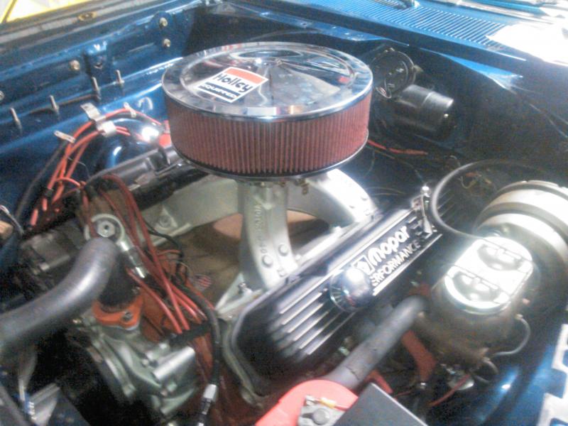

Hopefully, this is what it will look like.

So, it looks like the intake ports are about .050 too high.
